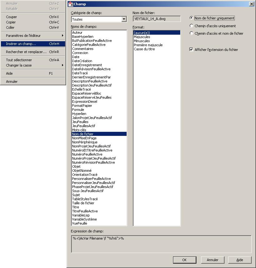

For the "automatic" informations that you want to place on your drawing, in a corner, horizontal or any other angle, inside a tittle block like the file number with the revision etc... you can lay a text an declare it as a"field" ( verify the english spelling ) by editing and with aright clic go to the "insert a field"  ( Ctrl+H ) option ( see the printscreen here enclosed ).
