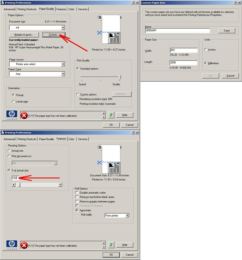

How can I plott from AutoCAD 2013 an PDF ca. 841x1500, 841x1800, 841x2100, 841x2650 ect.

Hello Boje, I think that you can print a PDF or anything you want to a "custom format".
Things may be different on YOUR computer because of the settings panel of YOUR printer.
See the print sreen here under.
