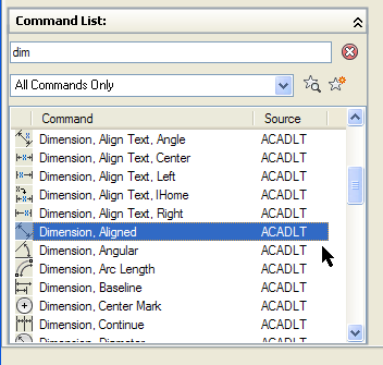

The two commands that do not show up at the Command list.
If type DIM at the commands list, dim commands show up, but as soon as add a R to Dim (DIMR)the command list goes blank.
Dimreassoc
Dimrotated
are the commands I would like to add to my custom toolbar.

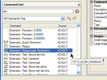

Dimension, Reassociate Dimensions does indeed show up on the list of commands.  I'm looking at it right now (AutoCAD 2012).

Yup.  Both there in the Command List on the CUI page.  I'd recommend you create a custom toolbar with these two commands and any others you regularly use.  Follow the steps in my paper above and get your system set up just the way you like!

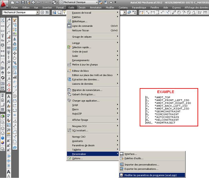

Hello javierperez, you can also update your acad.pgp file so you can use short alias.
Here is where to find it on AutoCAD Mechanical ( 2012 french release ).
You can find your PGP file in C\Program files\Autocad or Autodesk....... with asearch with the word acad.pgp.
I you update it directly from AutoCAD you will have to reinit it ( command REINIT ) or shut and open again your AutoCAD.
