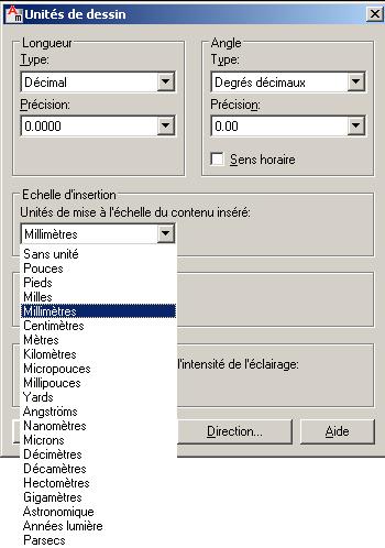

Hello Flx_18, if you want to be sure of the scale of blockw and files that you insert then you will have to open each of them and check/set the "insertion scale" that is set in DDUNITS ( see the print screen in french here ).
On the other hand it should not be to much difficult to make a difference between mmilimetres, meters, inches, feet.
1 mile = 8 furlong ( fur )
1 furlong = 220 yard ( yd )
1 yard = 3 foot ( ft )
1 feet = 12 inch ( in )
1 inch = 1000 mil ( mil )
Yes, I open 2 window first window is my layout and second windows is my cad blocks I want insert to my layout..Both of windows I setup insert scale with same mm but the cad blocks I copy paste after it's to big or to small??How can I fix it, because the cad blocks it's over big...Thank you for helping me...

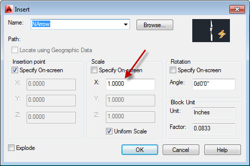

Generally, blocks should be INSERTed... not copy/pasted.  You get more options with INSERT.  One of the main ones is the ability to scale the block to your liking.  Once you have one in your drawing at the scale you like THEN you can use copy/paste.  But generally you should use INSERT.
