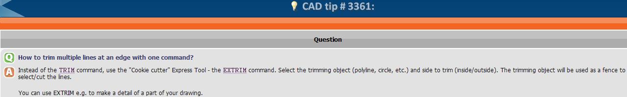

See the TIP N° 3361 right here in the site : how to trim multiple lines at an edge with one command?
