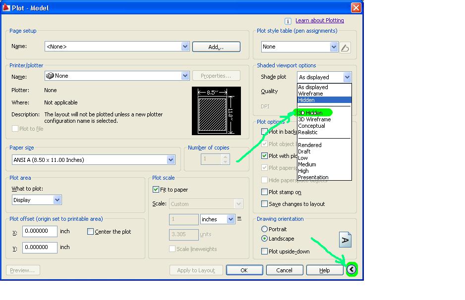

Welcome to CADFORUM.
 I have attached the plotting screen check in.

Direct Link To This Post Posted: 28.Jul.2008 at 20:35
Thanks for the quick response.
We do all of our printing using the layouts... and we turn on the hidden plot feature via the view port. But this does not plot the hidden lines....
It only hides the drawing not showing any hidden lines.
With the older versions of AutoCAD we could type in "turnhiddenlineson" or "turnhiddenlinesoff" and it would plot with the hidden lines on or off.
3D Hidden shows the lines behind other objects but they do not appear as a hidden line type.
I was wondering if there is an option for that in 2009.
Thanks again for your help.

Use LTSCALE on your viewport or check  VSOBSCUREDLTYPE variable.
