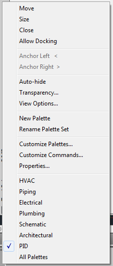

Here is a screen capture of what I get when I right clik on the gray area of the tool palette I created:

That top menu looks correct to me.  You were in the right place, you just clicked the "wrong" Customize choice.  Embarrassed
Click Customize Palettes and try again.  That's the one you need to complete the instruction set I wrote up above.
