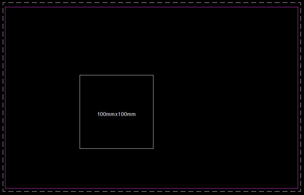

Hello together:
my question:
I want to print the drawn line in 1/1 millimeter.
for example:
I use the command to draw a 100x100 quadraht
I use the Dimension and get on all four sides
the dimensions 100.
Now I would like to print this object
but the dimensions of the pressure is not equal to 100
what setting is needed
to obtain a 1/1 drawing
thanks in advance

I'll assume we are talking about a 100x100 millimeter square.
You should have no problem printing it at a 1:1 scale on a A4 size piece of paper.
The best method to use would be one that takes advantage of a paper space layout and a viewport.  The viewport should be on its own layer and use a distinct color (something different than the layer/color of your model space objects).
It is the viewport that a scale is applied to.  Since you are then plotting from a layout your layout scale should be 1 unit = 1 mm.  Do NOT use the "Fit to Paper" option.

A4 size paper.  Viewport on its own layer (color: magenta).
The box is 1:1.
