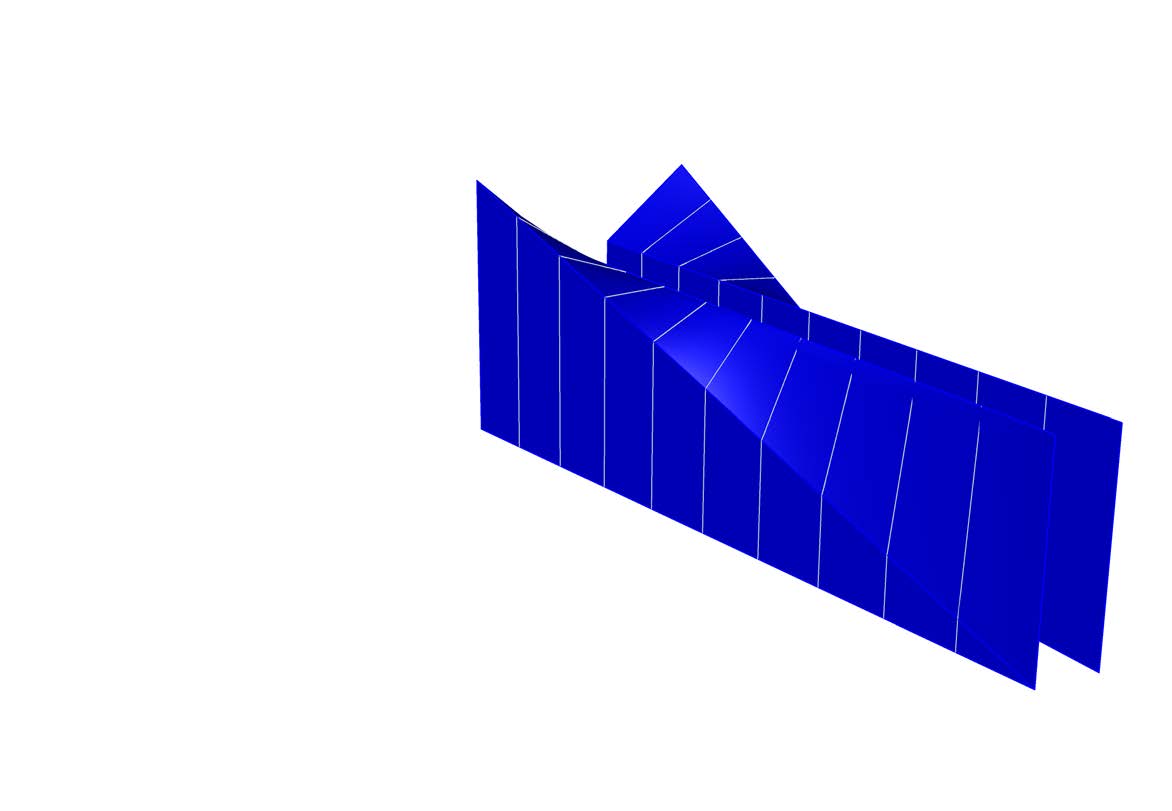

Hello!
I created an object with surfaces and can't modify it to a solid. Could anyone please suggest me how to do it? I created the surfaces as needed by the commands SURFNETWORK, Planesurf and loft. The white lines are sections. uploads/399360/rig_hh_4_sections.dwg Thanks in advance ![]() |

Try to convert it to NURBS Surfaces, then UNION and then CONVTOSOLID. I had some (limited) success with this workflow on your model.

CONVTONURBS did not work:
Command: _CONVTONURBS 5 found 5 not selected, not a valid object type. Did I something wrong? |

There are several LINES and SPLINES in your drawing - they were not converted, but the rest was. You can also delete them with QSELECT.

Posted: 27.Aug.2013 at 13:24 |
Worked. Thank you!
