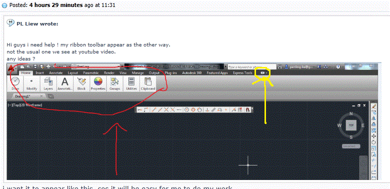

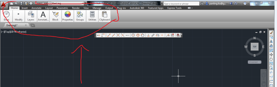

Hi guys i need help ! my ribbon toolbar appear as the other way.
not the usual one we see at youtube video.
any ideas ?

i want it to appear like this. cos it will be easy for me to do my work.
please see the attached picture below.

Try switching workspaces and see if that does the trick.
If that doesn't work try resetting your Profile.
Neither work?  Then it's time to start thinking about using a bigger hammer.

You need to click the Minimze botton. And choice the chose you like. You may have to click it two or three times.

2 Eagles (welcome to the forum btw!) is correct.  The OP simply minimized the ribbon.
Another solution is to double click any of the ribbon tabs (Home-Insert-Annotate-Etc).  This will also cycle the ribbon display.  Eventually (with enough dbl clicks of a tab) you eventually cycle back to the full display you want.

thanks.Tongue
