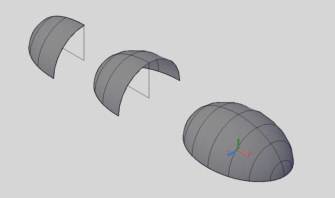

Can someone help me with how I can create a 3D model of an elliptical dome?
The ellipse dimensions are 14"wide x 18" long and the dome is 4" high. This would be the cover for an elliptical manway on a pressure vessel.

Here is the elliptical shape you described.  It was produced by an plugin app that, unfortunately, is not available for AutoCAD 2009.uploads/244286/Ellipsoid.dwg

A dome like that can be constructed in 3D with a segment of an ellipse that is revolved.  Did you want to end up with a surface or a solid?

This is how I did it.  By the way, it is a revolvedsurface.  You can union the four pieces together to form a regular surface then you can use the Thicken command to turn it into a solid.

I don't think RevolveSurface can be used due to the squashed height of 4".  Loft can be used but creating an ellipsoid with tight tolerances (Mathematically correct surface area and volume) is difficult.
I think the "app" reference pertains to the one I alluded to in my post.  Unfortunately, The compatibility of the routine is only AutoCAD 2011 - 2012.  If needed, I'll try to update to 2013 - 2014, but it wouldn't be available until later this week.  In the mean time, this link has some discussion on the matter as well as hosting my current routine and a lisp variant by Marko Ribar.  See Reply 14.

Can you do it with a one-inch diameter hemispherical dome (quite simple to construct), defined as a Block and inserted with appropriate differing X, Y and Z scale factors?

Yes Kent you can do it and it works.
I did a bloc 1x1x1 with a half sphere and scale it to X:14 , Y:18 , Z:8.
I did an other bloc at scale X:13 , Y:17 Z:7 to figure the volume to be taken out of the first one ( would be a volume of thickness 1" ) but I was not authorized to explode these blocks "non uniform scale".

Phillippe, AutoCAD includes capabilities in its APIs that are not exposed to the drawing editor.  One of the capabilities allows for degree 2 NURBS surfaces.  I used that to sculpt the ellipsoid solid attached to post #2.
I see you are using AutoCAD Mechanical 2012.  That is the same version I used when running the plugin ellipsoid.dll attached to post # 14 of the theswamp.org link above.  I do understand, though, reluctance to run outside code.
The source code for that routine can be inspected (and/or used to compile) here:
