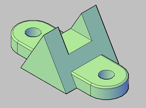

Here is a representative 3D solid model.  I'm going to next show you an image of three 2D views created of the model using the SolProf command.

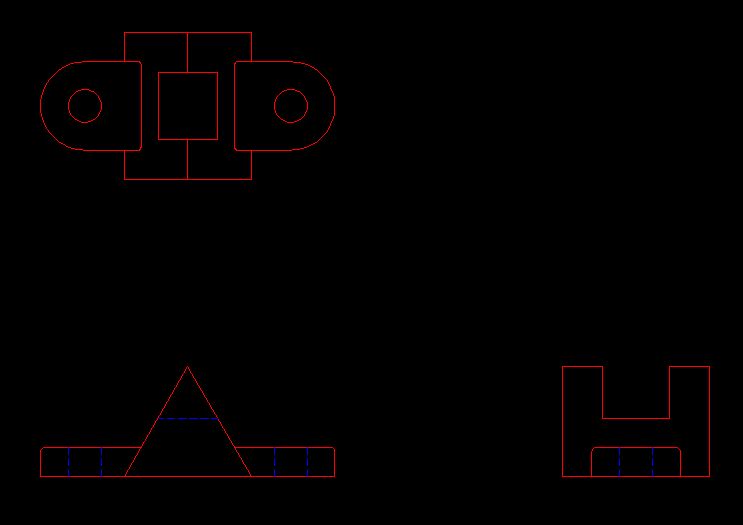

Here you go.  Top, front and side view.  The solid and hidden lines are blocks on two different layers.  The blocks are situated in model space.  AutoCAD creates the two layers automatically but their default color and linetype can be changed in the Layer Properties Manager.

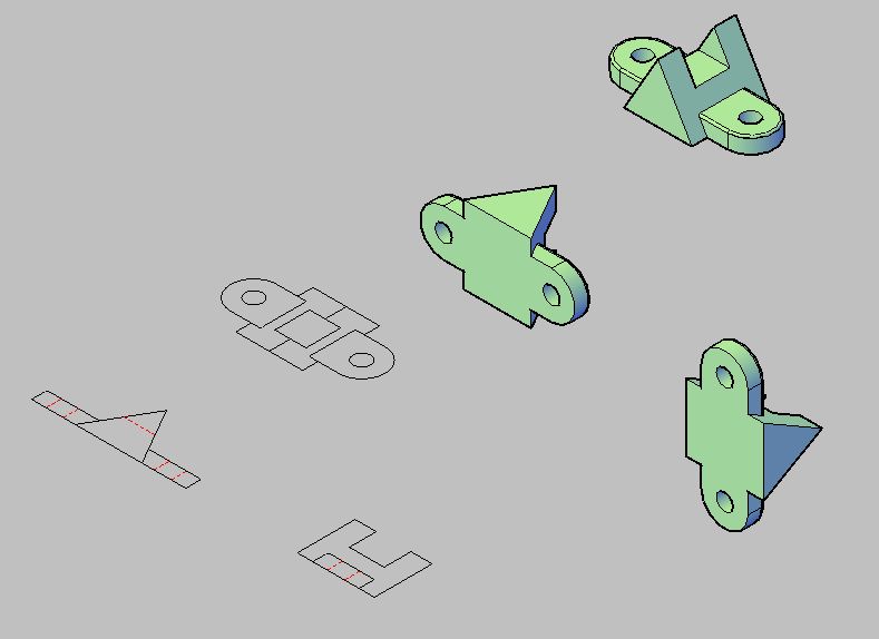

I included both the 3D solid objects and the results of the Flatshot command in this one image.
<<AutoCAD 2015>>
