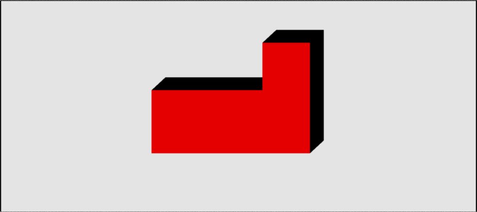

John Connor
Senior Member
Joined: 01.Feb.2011 Location: United States Using: AutoCAD 2018 Status: Offline Points: 7175 |
Posted: 03.Dec.2013 at 16:00 |
Simple one story building. Flat room. Date: 1-Aug-2013. Time: 1:35 pm on west coast of U.S. This is with full shadows. |

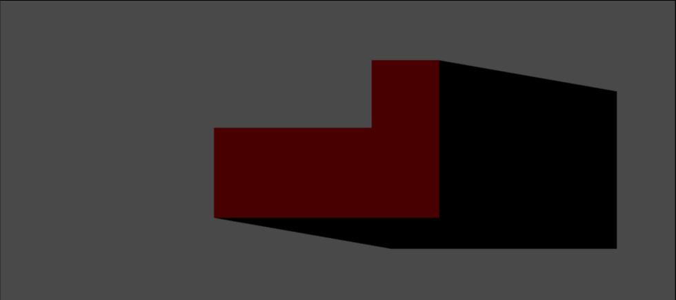

John Connor
Senior Member
Posted: 03.Dec.2013 at 16:02 |
Same structure. Date: same. Time: 5:44 pm. Location: same. Full shadows. What's different about the angle of the shadows as compared to my first image? |

John Connor
Senior Member
Posted: 06.Dec.2013 at 11:24 |
A PDF is no good unless it will have all the necessary dimensions of the building along with heights and even then if the building is as complex as you say then it would still be useless. The best option is a full 3D drawing of the building but I don't know if you'll be able to attach the drawing file to your post due to file size limits. You may have to upload it to the Blocks section instead.
