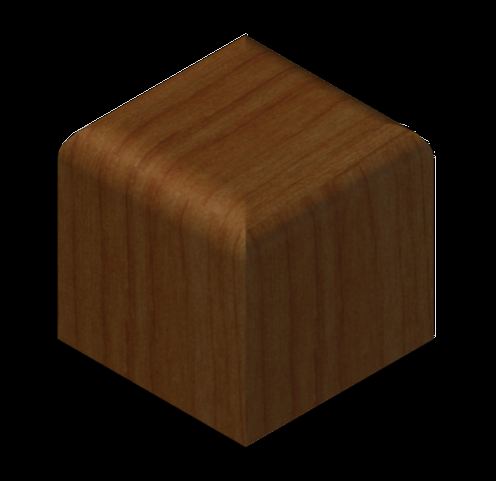

I just happen to be running 2014 so I drew a 3D solid box (6x6x6), filleted the top edges (all four), applied a birch - solid stain dark no gloss material, used the default lighting setting and did a "render region" of just the box and no error was encountered.
What are the particulars of your box/material/lights?  I'll try to replicate what you are doing.

My results using AutoCAD 2014.
