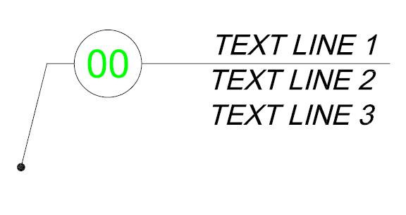

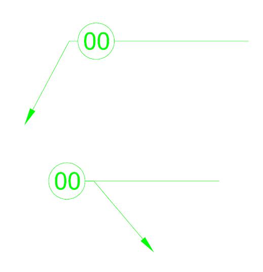

Hello,
How can I create this tipe of multileader? Sometimes I need to use only text line 1, but sometimes I need text line 2 and 3 as well. I know I have to create a block and insert multileader block options in multileader type: block. But it is not working the best mode for me if I move it from right to left... I have to create a dynamic block with flip option? How can I add text lines? Pleas Help me if you can! |

You will need a dynamic block to do this. You'll have attributes for the three text lines and for the number in the bubble. It will also have to have flip, move and stretch parameters to make it fully functional, ie, to allow you to reposition it as needed. It's not a trivial build, but a little tricky is all.

Try out the attached. The only "gotcha" in it is that it won't like being dragged by the tip of the arrowhead - so move it by the "shoulder' point instead. Other than that it's pretty much what you were looking for. It's also set up to be annotative... if that matters to you, with text size set to 1/8". Feel free to modify any or all of this to your liking.
Dave.uploads/35918/3-Line-MLeader-Bubble.dwg Edited by heinsite - 10.Feb.2014 at 19:52 |

Thank you Dave!
It's perfect for me! THANK YOU! |
