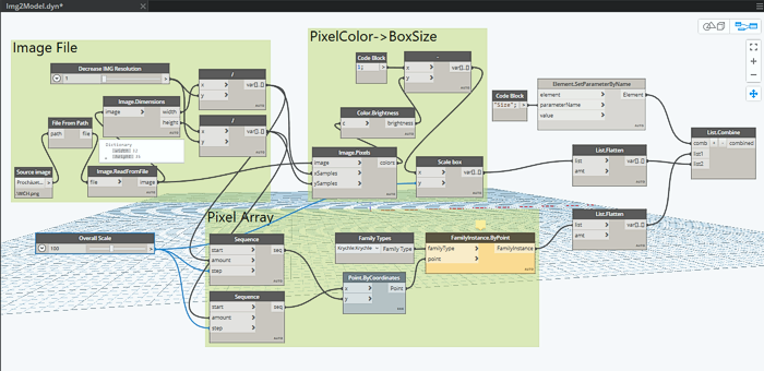

Dynamo
We can now assemble a visual recipe for processing an image into a rectangular array of 3D "pixels". Using Manage > Visual Programming > Dynamo, start the Dynamo module in Revit and start specifying the individual steps (nodes) of the procedure.

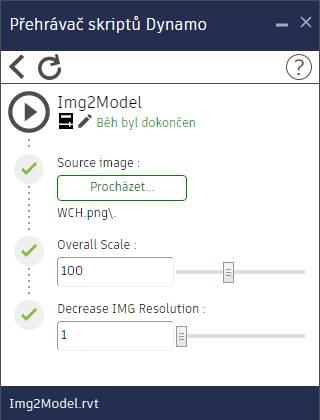

The Dynamo script consists of 3 basic parts - loading the source photo, creating an auxiliary rectangular array of "3D pixels" and sizing these "pixels" according to the brightness of the corresponding pixel in the source photo. The input parameters will be the selection of the source raster file (all supported image formats), the downsampling ration for possible large images (e.g. for the original size of 1000px use approx. 20) and the overall scale of the resulting model (1 = unit size of "3D pixel").
Output
You can download the finished Img2Model.dyn script from the Download page. Use the Manual mode in Dynamo to edit and run the script as the script may take a few minutes to run. The result of the script is then a similar model:
You can preset this or any other Dynamo script (with correctly set input parameters) for a quick launch in Dynamo Player. Copy it to the folder C:\ProgramData\Autodesk\RVT 2021\Dynamo\samples\en-US\Revit\DynamoPlayer-4\ or add your script folder to the Dynamo Player. You can then run it directly from the Revit ribbon:
