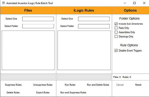

How to bulk transfer iLogic rules and forms from Inventor source documents?
A - answer I'm transferring old documentation and models. In the drawings I have replaced the old title blocks with new ones using the "Drawing Resource Transfer Wizard", but now I need to bulk transfer iLogic rules and forms from the source files (I cannot use external rules). How can I do this?
For bulk transfer (import) of iLogic macros/rules, you can use the add-on app iLogic Rule Batch Tool (see Autodesk Apps) - it is available for all Inventor users with active subscription.
