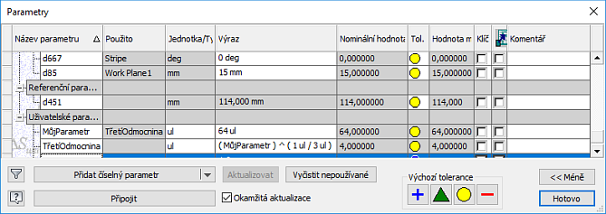

How to calculate a cube root in Inventor parameters?
A - answer To compute a cube (third) root and any general higher n-order roots in Inventor parameters, use the expression:
=ParamValue^(1/n)
So e.g. for the cube root of the parameter "MyParameter" use the expression:
=(MyParameter) ^ (1 ul / 3 ul)
