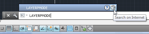

A - answer AutoCAD 2014 (and the whole 2014-AutoCAD family) offers to search for the typed command on the internet - directly on the commandline, by clicking on the globe icon:
Search
The default search engine is Google.com. You can change it to your favorite search engine service through the Registry.
