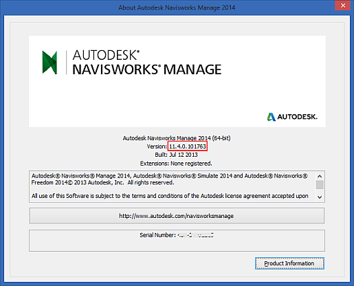

How to find if SP1 was installed in Navisworks 2014?
A - answer A successfully installed Service Pack 1 in aplikaci Autodesk Navisworks can be identified from the field "Version" in the dialog "About Autodesk Navisworks". This dialog can be displayd with the function "About Autodesk Navisworks 2014" in the menu under the question-mark icon in the application top bar.
The originally installed version has the version number 11.0.0.98373, after the installation of SP1 this version number changes to 11.4.0.101763 and the Built date to July.
Before ("SP0"):
After ("SP1"):
