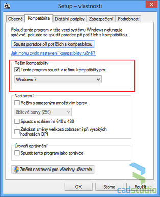

- In the file explorer, right-click on the installation program setup.exe, choose Properties in the context menu and on the Compatibility tab, set the Windows 7 compatibility mode; save your setting with OK:

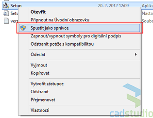

- Right-click again on setup.exe and run this program "As Administrator":
(not neccessary if your account is a member of the local Administrators group)

- After the installation is completed, right-click on the newly created desktop icon (launch shortcut) or directly on acad.exe and again set its compatibility mode to Windows 7 (similarly as in step 3)
- Right-click on the CAD application shortcut (or .exe) and choose "Run as Administrator" (not neccessary if you are a local Administrator or if you have disabled the UAC mode)

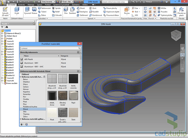

Now a standard, fully working CAD application should be launched in Win8 - AutoCAD:
or Inventor:

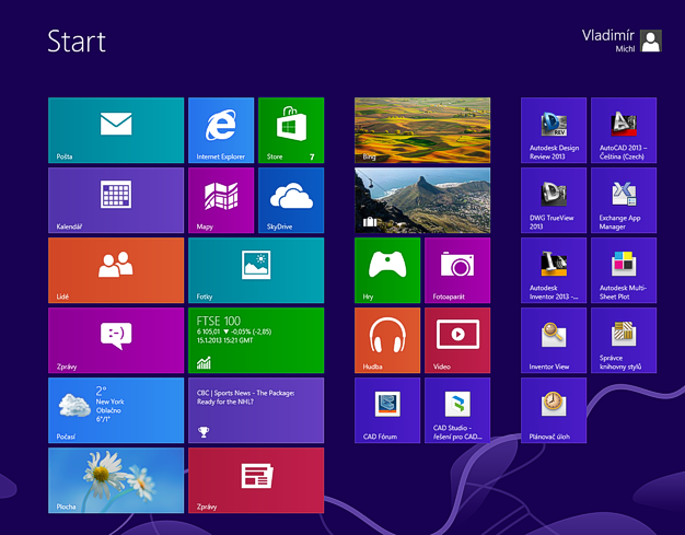

Customize the shortcut tiles on the Windows 8 startup screen (Metro, resp. Modern UI) to run your CAD applications conveniently.
