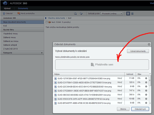

How to upload entire folders to the cloud Autodesk 360?
A - answer If you need to transfer a whole contents of a given folder (all documents) to the cloud Autodesk 360 - e.g. all photos for conversion to a 3D model in ReCap Photo - use the drag-and-drop function.
Open the requested target folder in A360 Documents and click on Upload - the "Upload documents" web panel will display. Select all files in your local folder in Windows Explorer (or other file manager) and drag-and-drop them with your mouse on the "Drop here" pane. Confirm the batch upload with the "Upload Now" button.
