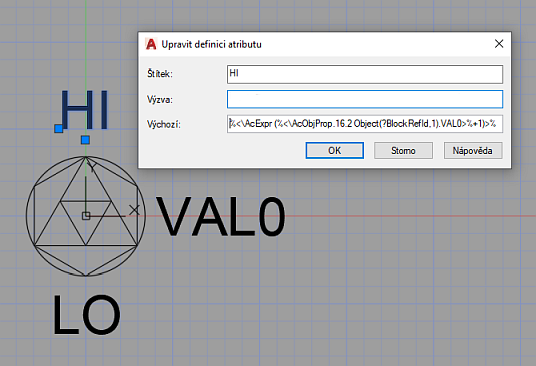

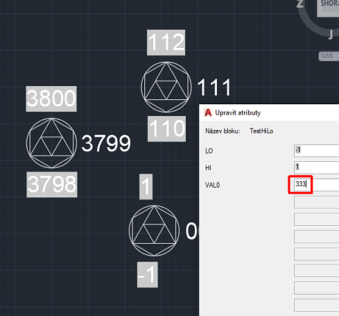

To calculate values through the block definition you can also use a simplified method independent of dynamic blocks, with simple automatic updates on block insertion and on any subsequent DWG Open or Regen operations.
An example - the block TestHiLo (see) with the controlling master attribute "Val0" and with two dependent attributes "Hi" and "Lo". These will be automatically assigned values always incremented and decremented by one off the value set to the master attribute. Just insert the textual form of the calculation expression to their preset (default) values - here specifically:
%<\AcExpr (%<\AcObjProp.16.2 Object(?BlockRefId,1).Val0>%+1)>%
and:
%<\AcExpr (%<\AcObjProp.16.2 Object(?BlockRefId,1).Val0>%-1)>%
