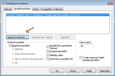

Run the MSCONFIG command (Start > Run) and go to the "Boot" tab. There click the "Advanced options" button. In the "BOOT advance options" dialog check the "Number of processors" option and set the number of processor cores you have available in your PC. Exit the command with OK. The following restart should be faster.
MSCONFIG Vista64 (CZ version)
MSCONFIG - number of processors (CZ version)
