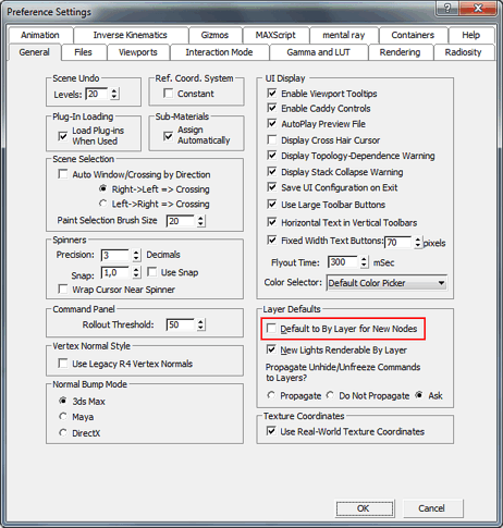

In Customize > Preferences > General uncheck the option "Default to By Layer for New Nodes" and confirm the dialog:

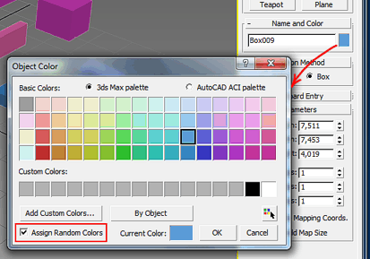

In the object creation panel then click on the color swatch and in the dialog "Object Color" check the option "Assign Random Colors":
random color hue
