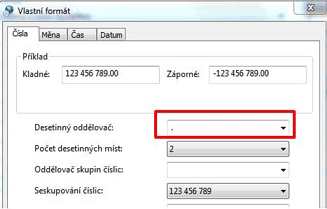

Some coordinates in isometric are displayed with decimal places.
A - answer Even when you suppress displaying decimal places for coordinates in a Plant isometric drawing, some coordinates are displayed with decimal places.
This is caused by regional settings in your operating system, when you have set a comma (",") as a decimal separator. Setting the separator to a dot (".") will solve a proper generation of coordinates.
