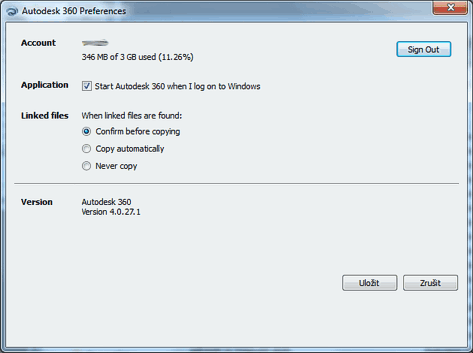

With the Autodesk 360 icon in system tray (rotates when performing cloud communication) you can control other A360 functions (on right-click) and you can set the sync modes.
The Preference option starts a dialog where you can see your currently consumed cloud storage capacity and you can set synchronization of linked files.
