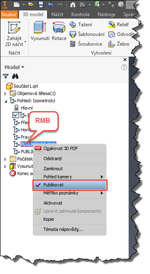

The Publish property at View representations.
A - answer The context menu for View representations in the Inventor 2017 browser tree offers a new property "Publish". What is it for?
This function controls publishing to the 3D PDF. If it is not checked (off) then the given view representation is not automatically selected (added) for publishing (but you can subsequently add it in the publishing dialog).
