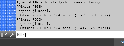

The any AutoCAD command simply displays a report (on the command line) about the execution time of that command - e.g.:
CMDtimer> REGEN: 0.531 secs (1798366440 ticks)
It lists the total time in seconds and the exact number of CPU "ticks". In this way you can easily measure the influence of different display settings, fonts or simplified geometry, especially on large drawings (benchmarks).
