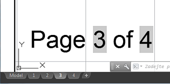

A - answer AutoCAD does not offer the total number of layouts as a system variable so you cannot easily use automatic text fields of the type "Page X of Y" to your title blocks.
With help of the TotalLayouts reactor (or the PageOf utility, see below) you can add this possibility of multiple layout numbering to your AutoCAD and automate your batch plots.
TotalLayouts
To compose such automatic text, you will need two text fields - the current page/layout name/number and the total number of layouts (pages). The current layout name can be accessed through the variable CTAB so this field is available in Other > System variable:

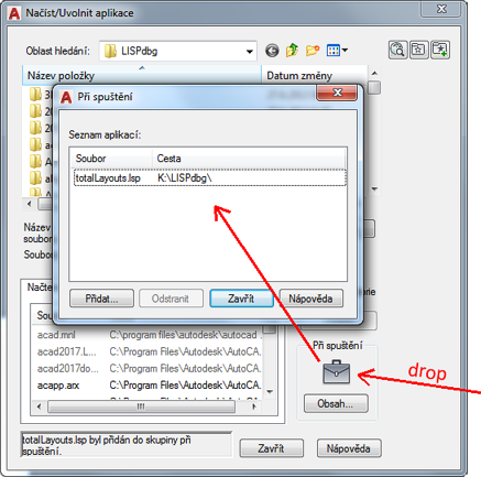

The code can be downloaded from Download. To load and run the code automatically in each DWG drawing session in your AutoCAD, add it to your Startup Suite in APPLOAD - drag the downloaded LSP file (stored in an AutoCAD support folder) onto the briefcase icon in the AppLoad dialog.
