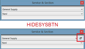

Why is the edit button for service database hidden in Fabrication CADmep?
A - answer If your dialog "Service & Section" does not display the function (icon, button) for editing service database, you can restore it (On/Off toggle) with the command:
HIDESYSBTN
Enable edit - show
