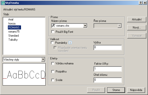

    <![CDATA[<strong>Autor:</strong> <a href="https://www.cadforum.cz/forum/member_profile.asp?PF=270">PepaR</a><br /><strong>Předmět:</strong> 12965<br /><strong>Zasláno:</strong> 30.kvě.2011 v 11:30<br /><br /><div style="border-top-width: 0px; border-right-width: 0px; border-bottom-width: 0px; border-left-width: 0px; border-style: initial; border-color: initial; font-family: Verdana, Arial, Helvetica, sans-serif; color: rgb(48, 56, 63); font-size: 12px; : rgb(255, 255, 255); "><span ="Apple-style-span" style="font-weight: normal; ">Je to jak píše Petr75, ve stylech písma (Formát - Písmo) je nutné u stylu </span><b>ROMANS </b>nastavit <b>výšku písma</b> na hodnotu <b>0</b>. Pak to bude fungovat (pozor, regen mi nezabral, bylo nutné protáhnout kótu).</div><div style="border-top-width: 0px; border-right-width: 0px; border-bottom-width: 0px; border-left-width: 0px; border-style: initial; border-color: initial; font-family: Verdana, Arial, Helvetica, sans-serif; color: rgb(48, 56, 63); font-size: 12px; : rgb(255, 255, 255); "><img src="uploads/20110530_112941_Koty_Pismo.png" height="400" width="620" border="0" /><br></div>]]>
