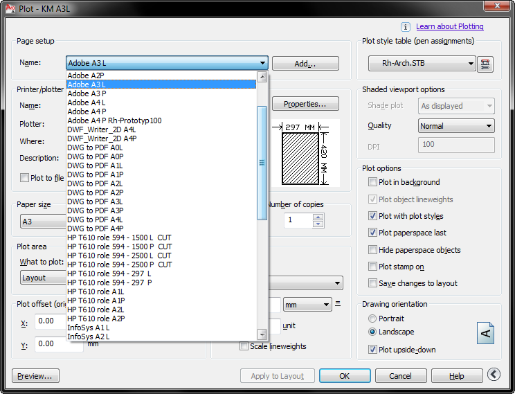

    <![CDATA[<strong>Autor:</strong> <a href="https://www.cadforum.cz/forum/member_profile.asp?PF=1753">splonk</a><br /><strong>Předmět:</strong> 13720<br /><strong>Zasláno:</strong> 26.říj.2011 v 15:18<br /><br /><table width="99%"><tr><td class="BBquote"><img src="forum_images/quote_box.png" title="Původně odeslal(a) Vladimír Michl" alt="Původně odeslal(a) Vladimír Michl" style="vertical-align: text-bottom;" /> <strong>Vladimír Michl napsal(a):</strong><br /><br />Jakékoliv doplnění DelPageSetup nebo podobných našich utilit je vítáno, se zveřejněním není problém.</td></tr></table> <DIV></DIV><DIV></DIV><DIV>&nbsp;</DIV><DIV>OK, sice to neni zadny zazrak...</DIV><DIV>Prikaz nejdriv smaze vsechny Pagesetupy a pak naimportuje vsechny PageSetupy z nadefinovaneho souboru</DIV><DIV>&nbsp;</DIV><DIV>&nbsp;</DIV><DIV><table width="99%"><tr><td><pre class="BBcode"></DIV><DIV>;;**************&nbsp; DelPageSetup(s) -&gt; ImportPageSetups&nbsp; *********************<BR>; Deletes Page Setup(s)<BR>; --- <a href="http://www.cadforum.cz" target="_blank">www.cadforum.cz</A> ---<BR>; (wildcards allowed)<BR>(vl-load-com)</DIV><DIV>(defun DelPageSetup ( Name / Cfgs x)<BR>(setq Cfgs<BR>&nbsp;(vla-get-plotconfigurations<BR>&nbsp;(vla-get-activedocument<BR>&nbsp;(vlax-get-acad-object))))</DIV><DIV>(cond<BR>&nbsp;((vl-string-search "*" Name)<BR>&nbsp; (vlax-for x Cfgs<BR>&nbsp;&nbsp; (if (wcmatch (vla-get-name x) Name)<BR>&nbsp;&nbsp;&nbsp; (vla-delete x)<BR>&nbsp;)))</DIV><DIV>&nbsp;(T<BR>&nbsp; (vl-catch-all-apply<BR>&nbsp;&nbsp;&nbsp; '(lambda () (vla-delete (vla-item Cfgs Name)))<BR>&nbsp;))<BR>)<BR>(princ)<BR>)</DIV><DIV>(defun C:PSA ( / psname)<BR>&nbsp;;(setq psname (getstring "Page setup name(s) to delete (*=all): "))<BR>&nbsp; (DelPageSetup "*")&nbsp;;psname)<BR>&nbsp;&nbsp; (princ "\n** OLD page setups was removed successfully**")<BR>;;<BR>;;IMPORT PAGE SETUP<BR>;;this part is provided by JASponza</DIV><DIV>&nbsp;&nbsp; (setvar "filedia" 0)<BR>&nbsp;&nbsp; (setvar "expert" 5)<BR>&nbsp;&nbsp; (setvar "cmdecho" 0)<BR>;vyse uvedene promenne je mozna lepsi zmenit klasicky <BR>;pomoci getvar -&gt; setvar tak, aby se vratila puvodni hodnota<BR>&nbsp;&nbsp; (command "psetupin" "Rh-Layouty.dwt" "*")<BR>;Rh-Layouty.dwt je nazev souboru s ulozenymi PareSetups<BR>;Cesta k slozce osahujici teto soubor musi byt zadana v Options|Support File Search Path<BR>;Popropade by slo napsat "Plnou cestu" k souboru - ztarci se tim ale flexibilita<BR>&nbsp;&nbsp; (setvar "filedia" 1)<BR>&nbsp;&nbsp; (setvar "expert" 0)<BR>&nbsp;&nbsp; (princ "\n** NEW page setups was imported successfully**")<BR>&nbsp;(prin1)<BR>)<BR></pre></td></tr></table></DIV><DIV>&nbsp;</DIV><DIV>Lisp se spousti pomoci PSA.</DIV><DIV>Je potreba upravit nazev souboru "LayoutTemplate"...</DIV><DIV>V Options je potreba zadat cestu tak, aby CAD umel najit vyse zmineny soubor.</DIV><DIV>Vubec, celkove to jde asi napsat lip.</DIV><DIV>&nbsp;</DIV><DIV>Snad jsem to vysvetlil nejka srozumitelne - kdyztak napiste ;-)</DIV><DIV>&nbsp;</DIV><DIV>Zdravim</DIV><DIV>JASponza</DIV>]]>
   </description>
   <pubDate>Wed, 26 Oct 2011 15:18:15 +0000</pubDate>
   <guid isPermaLink="true">https://www.cadforum.cz/forum/forum_posts.asp?TID=13720&amp;PID=65127&amp;title=smazani-nepotrebnych-formatu-papiru#65127</guid>
  </item> 
  <item>
   <title><![CDATA[Smazání nepotřebných formátů papíru :   Jak&#233;koliv dopln&#283;n&#237; DelPageSetup...]]></title>
   <link>https://www.cadforum.cz/forum/forum_posts.asp?TID=13720&amp;PID=65124&amp;title=smazani-nepotrebnych-formatu-papiru#65124</link>
   <description>
    <![CDATA[<strong>Autor:</strong> <a href="https://www.cadforum.cz/forum/member_profile.asp?PF=9">Vladimír Michl</a><br /><strong>Předmět:</strong> 13720<br /><strong>Zasláno:</strong> 26.říj.2011 v 14:36<br /><br />Jakékoliv doplnění DelPageSetup nebo podobných našich utilit je vítáno, se zveřejněním není problém.]]>

    <![CDATA[<strong>Autor:</strong> <a href="https://www.cadforum.cz/forum/member_profile.asp?PF=1753">splonk</a><br /><strong>Předmět:</strong> 13720<br /><strong>Zasláno:</strong> 26.říj.2011 v 10:07<br /><br />Dobry den<DIV>Tak to tedy zkusim popsat...</DIV><DIV>&nbsp;</DIV><OL><LI>Otevru si novy vykres a pojmenuju ho neco jako Layout_Template.dwt. Dwt proto,abych ho ulozil do slozky kde mam ostatni Templates (Sablony)&nbsp;a pomoci Ctrl+N mi CAD rovnou naskoci do okna s Templates&nbsp; - pochopitelne, musim to mit nastavene v Options...</LI><LI>Prekliknu se do nejakeho layoutu (to proto abych vytvarel Pagesetup pro PaperSpace a ne pro Modelovy prostor). Prikazem <EM>PAGESETUP </EM>vyvolam okno na nastaveni PageSetupu..., dam&nbsp;New (novy).</LI><LI>Zadam nazev&nbsp;PageSetupu (nejlepe je, napred si roziyslet zpusob pojmenovavani... napr. TISKARNA_FORMAT_NATOCENI... tzn. HPxxx_A3_L (L jako Landscape))<BR>Pote vyberu vzor od ktereho se dalsi nastaveni bude vyvyjet (pokud nic podobneho nemam, zvolim zadny)</LI><LI>Pak v Plot-okenku navolim vsechny moznosti tak, ajk jsem zvikly pri kazdem tisku (tzn. zvolim spravnou pc3-ku (kteropu ale predtim muim mit prednastavenou - vyrobenou), format papiru, orientaci, ... stb/ctb,... proste vsechna nastaveni v dialogovem okenku</LI><LI>Dam OK a dany PageSetup mam ulozen.</LI><LI>Stejnym zpusobem pokracuju pro kazdou tiskarnu kterou mam a pro kazde plot-nastaveni ktere pouzivam... Tzn napr. mam 2 tiskarny, na kazde chci mit formaty od A4 do A0.... tzn. budu mit 2*5*2 nastavenych PageSetupu.</LI></OL><P>Jak dostat tato nastaveni do jinych vykresu:</P><OL><LI>Otevru novy vykres</LI><LI>Do prikazoveho radku zadam PSETUPIN a v okenku vyberu cestu k LayoutTemplate (pokud jsem to ulozil jako *.dwt, tak vyberu format .dwt a rovnou jsem ve spravne slozce :-)).</LI><LI>Vyberu PageStup-s k importovani (pomoci podrzene klavesi Shift muzu vybrat vsechny) a je to...</LI><LI>Nevyhoda tohoto posupu je ihned patrna... zdlouhave browsovani, manualni vyber PageSetupu, neustale odklikavni pri prepisu PageSetupu stavajicich,........). Proto je toto dobre mit nadefinovane pod jednoduchym prikazem (v mem pripade Lisp-em).</LI></OL><P>Pochopitelne, je vhodne tato nastaveni mit preddefinovane v hlavni sablone... Nevyhodou ale je ze se nastaveni tiskaren muzou casem menit... nebo se tiskarna vymeni apod. Pak je vhodne updatovat stare PageSetupy a eventualne naimportovat nove. Tzn. v LayoutTemplate pravidelne aktualizuji PageSetupy a do ostatnich vykresu pravidelne updatuju :-)</P><DIV>Tato myslenka mne pred lety vedla k tomu, abych mirne doplnil lisp DelPageSetup vydano CADForem v IV/2008.</DIV><DIV>Proto bych se rad zeptal lidi poverenych pres autorska prava v CADStudiu zda muzu zde zverejnit jejich LISP doplnen o sekvenci kera provadi import pagesetupu z "natvrdo" zadaneho vykresu...?</DIV><DIV>&nbsp;</DIV><DIV>Predem DEKUJU</DIV><DIV>&nbsp;</DIV><DIV>JASponza</DIV><DIV>&nbsp;</DIV><DIV>&nbsp;</DIV>]]>

    <![CDATA[<strong>Autor:</strong> <a href="https://www.cadforum.cz/forum/member_profile.asp?PF=1753">splonk</a><br /><strong>Předmět:</strong> 13720<br /><strong>Zasláno:</strong> 14.říj.2011 v 15:35<br /><br />Dobry den<DIV>... anebo si, nekdy ve volnem case, predvyrobit PageSetup-y (Nastaveni starnky) kde bude pripraven avetsina formatu/tiskaren/.ctb-.stb/... .pc3 nastavena.</DIV><DIV>Prednost: uz zadne rolovani v pc3kach, papirech,...&nbsp;a v neposledni rade, jdou importovat z jinych vykresu (manualne i napr. LISPem) a mazat ze stavajicich - Pak se velmi snadno edituje napriklad cele nastaveni tiskarny (bez problemu se prida nova tiskarna s predyrobenymi pc3kami, a jednim prikazem tato nastaveni dostanu do jakehokoliv vykresu) - a bez toho si nedokazu predstavit praci v ACADu.</DIV><DIV>&nbsp;</DIV><DIV>Hezky den</DIV><DIV>JASponza</DIV>]]>

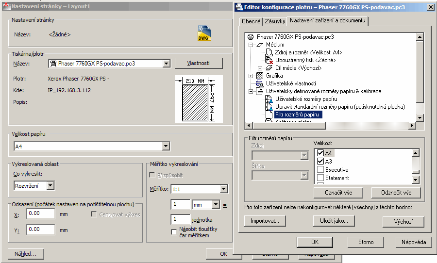

    <![CDATA[<strong>Autor:</strong> <a href="https://www.cadforum.cz/forum/member_profile.asp?PF=2271">Petr75</a><br /><strong>Předmět:</strong> 13720<br /><strong>Zasláno:</strong> 13.říj.2011 v 08:36<br /><br />Pokud používáte v AutoCADu kopie tiskáren, tj. s příponou PC3, tak si můžete nepotřebné formáty papíru vyfiltrovat.<br>Nastavení stránky -&gt; Vlastnosti -&gt; Filtr rozměrů papíru<br><img src="uploads/20111013_083526_tiskarna.gif" height="542" width="900" border="0" /><br>]]>

    <![CDATA[<strong>Autor:</strong> <a href="https://www.cadforum.cz/forum/member_profile.asp?PF=13771">Firestone</a><br /><strong>Předmět:</strong> 13720<br /><strong>Zasláno:</strong> 13.říj.2011 v 08:33<br /><br />Jůůů... to je ono. Díky moc za radu!&nbsp;<img src="https://www.cadforum.cz/forum/smileys/smiley32.gif" border="0" align="absmiddle" alt="Clap" />]]>
