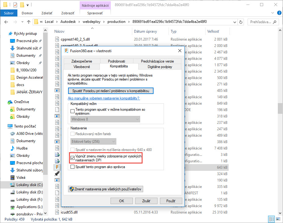

    <![CDATA[<strong>Autor:</strong> <a href="https://www.cadforum.cz/forum/member_profile.asp?PF=63773">Viktor Porubský</a><br /><strong>Předmět:</strong> 23947<br /><strong>Zasláno:</strong> 23.úno.2017 v 11:32<br /><br />Dobrý deň,&nbsp;<div><br></div><div>Máte nainštalovaný Windows 10? Ak áno, je možné že windows 10 aplikuje zmeny do prostredia fusion.&nbsp;</div><div><br></div><div>To sa dá ošetriť nasledovne:&nbsp;</div><div><br></div><div>prejdete do cesty:&nbsp;<span style="font-family: FrutigerNext, Arial, &amp;#12513;&amp;#12452;&amp;#12522;&amp;#12458;, Meiryo, sans-serif; font-size: 16px;">c:\users\%profile%\appdata\local\autodesk\webdeploy\production (musíte povoliť skryté zložky ak na to máte práva)</span></div><div><span style="font-family: FrutigerNext, Arial, &amp;#12513;&amp;#12452;&amp;#12522;&amp;#12458;, Meiryo, sans-serif; font-size: 16px;"><br></span></div><div><span style="font-family: FrutigerNext, Arial, &amp;#12513;&amp;#12452;&amp;#12522;&amp;#12458;, Meiryo, sans-serif; font-size: 16px;">Nájdite súbory:&nbsp;</span></div><ul style="-sizing: border-; margin: 10px 0px 10px 25px; padding: 0px; font-size: 16px; line-height: 1.6; list-style-: outside; font-family: FrutigerNext, Arial, &amp;#12513;&amp;#12452;&amp;#12522;&amp;#12458;, Meiryo, sans-serif;"><li style="-sizing: border-; margin: 0px 0px 5px; padding: 0px; line-height: 1.5rem; list-style-: disc;">FusionLauncher.exe</li><li style="-sizing: border-; margin: 0px 0px 5px; padding: 0px; line-height: 1.5rem; list-style-: disc;">Fusion360.exe</li></ul><div><font face="FrutigerNext, Arial, &amp;#12513;&amp;#12452;&amp;#12522;&amp;#12458;, Meiryo, sans-serif"><span style="font-size: 16px;">pravým tlačidlom na súbory vyberiete <b>vlastnosti</b></span></font></div><div><font face="FrutigerNext, Arial, &amp;#12513;&amp;#12452;&amp;#12522;&amp;#12458;, Meiryo, sans-serif"><span style="font-size: 16px;"><b><br></b></span></font></div><div><font face="FrutigerNext, Arial, &amp;#12513;&amp;#12452;&amp;#12522;&amp;#12458;, Meiryo, sans-serif"><span style="font-size: 16px;">a na karte <b>Kompatibilita</b> zaškrtnete hodnotu <b>vypnúť zmeny mierky zobrazenia pri vysokých nastaveniach DPI:</b></span></font></div><div><font face="FrutigerNext, Arial, &amp;#12513;&amp;#12452;&amp;#12522;&amp;#12458;, Meiryo, sans-serif"><span style="font-size: 16px;"><b><img src="uploads/63773/2017-02-23_11-30-55.jpg" height="731" width="927" border="0" /><br></b></span></font></div><span style="font-size:10px"><br /><br />Upravil Viktor Porubský - 23.úno.2017 v 11:36</span>]]>
