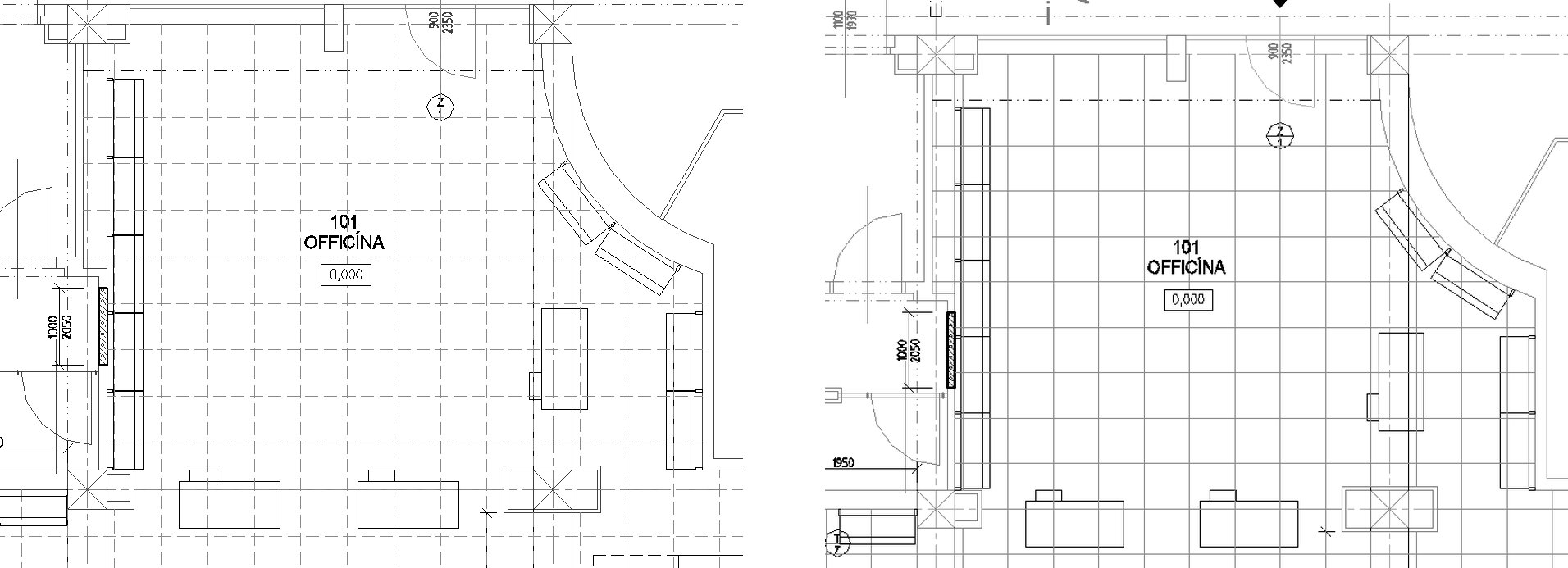

    <![CDATA[<strong>Autor:</strong> <a href="https://www.cadforum.cz/forum/member_profile.asp?PF=4547">alda</a><br /><strong>Předmět:</strong> 24153<br /><strong>Zasláno:</strong> 07.dub.2017 v 06:48<br /><br /><span style="color: rgb54, 69, 90; : rgb251, 251, 253;">HPLINETYPE zabralo. Zase nová proměnná.</span><div><span style="color: rgb54, 69, 90; : rgb251, 251, 253;">Děkuji.</span></div>]]>

    <![CDATA[<strong>Autor:</strong> <a href="https://www.cadforum.cz/forum/member_profile.asp?PF=9">Vladimír Michl</a><br /><strong>Předmět:</strong> 24153<br /><strong>Zasláno:</strong> 06.dub.2017 v 21:42<br /><br />HPLINETYPE - viz Tip 11382]]>

    <![CDATA[<strong>Autor:</strong> <a href="https://www.cadforum.cz/forum/member_profile.asp?PF=1045">johny</a><br /><strong>Předmět:</strong> 24153<br /><strong>Zasláno:</strong> 06.dub.2017 v 14:49<br /><br /><div>MEASUREMENT?</div><div><br></div><div><div>In the drawing that is messed up, do the following (in fact, do this for every one of your metric drawings)</div><div>&nbsp;</div><div>1. Enter the command MEASUREMENT and enter a value of 1</div><div>2. Enter the command LINETYPE, select and reload all the affected linetypes</div><div>3. Regen</div><div>&nbsp;</div><div>FYI</div><div>MEASUREMENT = 1 uses the ACADISO.lin for metric drawings</div><div>MEASUREMENT = 0 uses the ACAD.lin file for imperial drawings</div></div><div><br></div><span style="font-size:10px"><br /><br />Upravil johny - 06.dub.2017 v 14:57</span>]]>

    <![CDATA[<strong>Autor:</strong> <a href="https://www.cadforum.cz/forum/member_profile.asp?PF=1045">johny</a><br /><strong>Předmět:</strong> 24153<br /><strong>Zasláno:</strong> 06.dub.2017 v 14:19<br /><br />LTSCALE<div>Nebo pokuid jste v rozvrzeni pak PSLTSCALE</div><div>příp. MSLTSCALE</div><span style="font-size:10px"><br /><br />Upravil johny - 06.dub.2017 v 14:22</span>]]>

    <![CDATA[<strong>Autor:</strong> <a href="https://www.cadforum.cz/forum/member_profile.asp?PF=4547">alda</a><br /><strong>Předmět:</strong> 24153<br /><strong>Zasláno:</strong> 06.dub.2017 v 13:49<br /><br />Zdravím.<div>Přeskočil jsem na novějí ACAD 2017 a zjistil, e se nechtějí rafy zobrazovat dle typu čáry. Tentý výkres otevřený v ACAD 2012 fungoval správně viz obrázek. Nezjistil jsem co to ovlivňuje.</div><div><br></div><div>Díky za rady.</div><div><br></div><div><img src="uploads/4547/srafa.jpg" height="693" width="1912" border="0" align="left" /><br></div>]]>
   </description>
   <pubDate>Thu, 06 Apr 2017 13:49:22 +0000</pubDate>
   <guid isPermaLink="true">https://www.cadforum.cz/forum/forum_posts.asp?TID=24153&amp;PID=106419&amp;title=srafy-dle-typu-cary#106419</guid>
