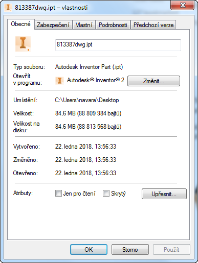

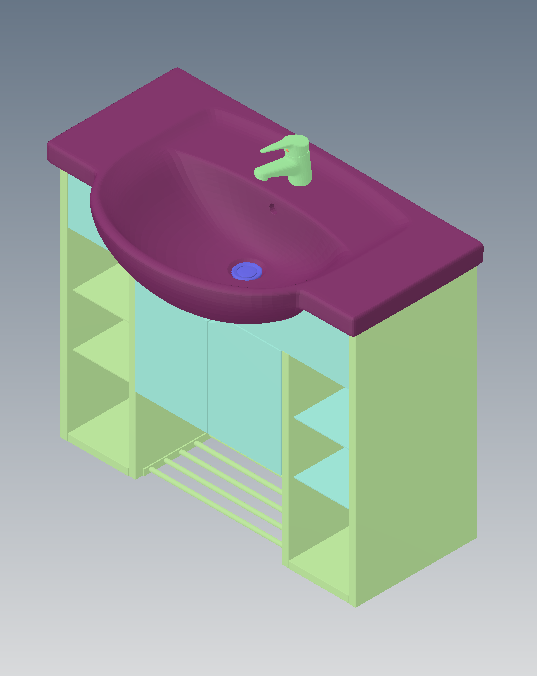

    <![CDATA[<strong>Autor:</strong> <a href="https://www.cadforum.cz/forum/member_profile.asp?PF=9996">Navara</a><br /><strong>Předmět:</strong> 25557<br /><strong>Zasláno:</strong> 22.led.2018 v 12:15<br /><br />Zkusil jsem to prohnat přes DWG -&gt; Acad 2016&nbsp;-&gt; IGES -&gt; Inventor 2018&nbsp;a šlo to, ale je to obluda.<div></div><div><img src="uploads/9996/22-1-2018_13-55-12.png" height="676" width="537" border="0" /><img src="uploads/9996/22-1-2018_13-57-27.png" height="515" width="387" border="0" /></div><div>EDIT: jiný model</div><span style="font-size:10px"><br /><br />Upravil Navara - 22.led.2018 v 13:58</span>]]>
