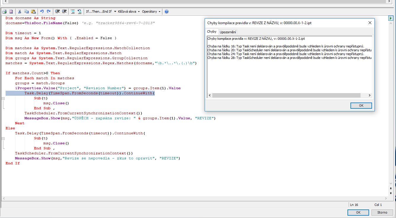

    <![CDATA[<strong>Autor:</strong> <a href="https://www.cadforum.cz/forum/member_profile.asp?PF=70369">Petr Žídek</a><br /><strong>Předmět:</strong> 28111<br /><strong>Zasláno:</strong> 05.pro.2018 v 12:54<br /><br /><div>Dobrý den,</div><div><br></div><div>ještě úplně nahoru vložit<br></div><div><br></div><div><font ="msgAtxt" size="2" face="Arial, Helvetica"><pre>Imports System.Threading.Tasks<br><br><font face="Verdana, Arial, Helvetica, sans-serif">při kopírování mi to vypadlo.</font><br></pre></font></div>]]>

    <![CDATA[<strong>Autor:</strong> <a href="https://www.cadforum.cz/forum/member_profile.asp?PF=4903">Lukáš Záruba</a><br /><strong>Předmět:</strong> 28111<br /><strong>Zasláno:</strong> 05.pro.2018 v 12:44<br /><br />Děkuji za radu ale pořád to hlásí tuto chybu:<div><br></div><div><img src="uploads/4903/MATH_BOX_3.JPG" height="740" width="1339" border="0" /><br></div>]]>

    <![CDATA[<strong>Autor:</strong> <a href="https://www.cadforum.cz/forum/member_profile.asp?PF=70369">Petr Žídek</a><br /><strong>Předmět:</strong> 28111<br /><strong>Zasláno:</strong> 05.pro.2018 v 12:31<br /><br /><div>Dobrý den,</div><div><br></div><div>co třeba takhle?<br></div><pre><span style="color: #FF0000; ">Dim</span> <span style="color: #800000; ">docname</span> <span style="color: #FF0000; ">As</span> <span style="color: #FF0000; ">String</span>  <span style="color: #800000; ">docname</span>=<span style="color: #800080; ">ThisDoc</span>.<span style="color: #800000; ">FileName</span>(<span style="color: #FF0000; ">False</span>) <span style="color: #808080; ">'e.g. "tracker9864-rev6-7-2013"</span><span style="color: #FF0000; ">Dim</span> <span style="color: #800000; ">timeout</span> = 1 <span style="color: #FF0000; ">Dim</span> <span style="color: #800000; ">msg</span> <span style="color: #FF0000; ">As</span> <span style="color: #FF0000; ">New</span> <span style="color: #800000; ">Form</span>() <span style="color: #FF0000; ">With</span> { .<span style="color: #800000; ">Enabled</span> = <span style="color: #FF0000; ">False</span> }<span style="color: #FF0000; ">Dim</span> <span style="color: #800000; ">matches</span> <span style="color: #FF0000; ">As</span> <span style="color: #800000; ">System</span>.<span style="color: #800000; ">Text</span>.<span style="color: #800000; ">RegularExpressions</span>.<span style="color: #800000; ">MatchCollection</span><span style="color: #FF0000; ">Dim</span> <span style="color: #800000; ">match</span> <span style="color: #FF0000; ">As</span> <span style="color: #800000; ">System</span>.<span style="color: #800000; ">Text</span>.<span style="color: #800000; ">RegularExpressions</span>.<span style="color: #800000; ">Match</span><span style="color: #FF0000; ">Dim</span> <span style="color: #800000; ">groups</span> <span style="color: #FF0000; ">As</span> <span style="color: #800000; ">System</span>.<span style="color: #800000; ">Text</span>.<span style="color: #800000; ">RegularExpressions</span>.<span style="color: #800000; ">GroupCollection</span><span style="color: #800000; ">matches</span> = <span style="color: #800000; ">System</span>.<span style="color: #800000; ">Text</span>.<span style="color: #800000; ">RegularExpressions</span>.<span style="color: #800000; ">Regex</span>.<span style="color: #800000; ">Matches</span>(<span style="color: #800000; ">docname</span>,<span style="color: #008080; ">"\b.*\..*\.(.)\b"</span>) <span style="color: #FF0000; ">If</span> <span style="color: #800000; ">matches</span>.<span style="color: #800000; ">Count</span>&gt;0 <span style="color: #FF0000; ">Then</span> 	<span style="color: #FF0000; ">For</span> <span style="color: #FF0000; ">Each</span> <span style="color: #800000; ">match</span> <span style="color: #FF0000; ">In</span> <span style="color: #800000; ">matches</span>  	<span style="color: #800000; ">groups</span> = <span style="color: #800000; ">match</span>.<span style="color: #800000; ">Groups</span>   	<span style="color: #800080; ">iProperties</span>.<span style="color: #800080; ">Value</span>(<span style="color: #008080; ">"Project"</span>, <span style="color: #008080; ">"Revision Number"</span>) = <span style="color: #800000; ">groups</span>.<span style="color: #800000; ">Item</span>(1).<span style="color: #800000; ">Value</span>  						<span style="color: #800000; ">Task</span>.<span style="color: #800000; ">Delay</span>(<span style="color: #800000; ">TimeSpan</span>.<span style="color: #800000; ">FromSeconds</span>(<span style="color: #800000; ">timeout</span>)).<span style="color: #800000; ">ContinueWith</span>(  			<span style="color: #FF0000; ">Sub</span>(<span style="color: #800000; ">t</span>)     			<span style="color: #800000; ">msg</span>.<span style="color: #800000; ">Close</span>()   			<span style="color: #FF0000; ">End</span> <span style="color: #FF0000; ">Sub</span> ,		<span style="color: #800000; ">TaskScheduler</span>.<span style="color: #800000; ">FromCurrentSynchronizationContext</span>())  		<span style="color: #800000; ">MessageBox</span>.<span style="color: #800000; ">Show</span>(<span style="color: #800000; ">msg</span>,<span style="color: #008080; ">"ÚSPĚCH - zapsána revize: "</span> &amp; <span style="color: #800000; ">groups</span>.<span style="color: #800000; ">Item</span>(1).<span style="color: #800000; ">Value</span>, <span style="color: #008080; ">"REVIZE"</span>) 	<span style="color: #FF0000; ">Next</span><span style="color: #FF0000; ">Else</span>	<span style="color: #800000; ">Task</span>.<span style="color: #800000; ">Delay</span>(<span style="color: #800000; ">TimeSpan</span>.<span style="color: #800000; ">FromSeconds</span>(<span style="color: #800000; ">timeout</span>)).<span style="color: #800000; ">ContinueWith</span>(  			<span style="color: #FF0000; ">Sub</span>(<span style="color: #800000; ">t</span>)     			<span style="color: #800000; ">msg</span>.<span style="color: #800000; ">Close</span>()   			<span style="color: #FF0000; ">End</span> <span style="color: #FF0000; ">Sub</span> ,	<span style="color: #800000; ">TaskScheduler</span>.<span style="color: #800000; ">FromCurrentSynchronizationContext</span>())	<span style="color: #800000; ">MessageBox</span>.<span style="color: #800000; ">Show</span>(<span style="color: #800000; ">msg</span>,<span style="color: #008080; ">"Revize se nepovedla - zkus to opravit"</span>, <span style="color: #008080; ">"REVIZE"</span>)<span style="color: #FF0000; ">End</span> <span style="color: #FF0000; ">If</span> </pre>]]>

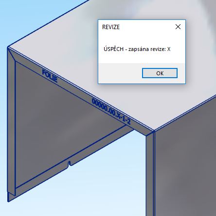

    <![CDATA[<strong>Autor:</strong> <a href="https://www.cadforum.cz/forum/member_profile.asp?PF=4903">Lukáš Záruba</a><br /><strong>Předmět:</strong> 28111<br /><strong>Zasláno:</strong> 05.pro.2018 v 12:06<br /><br />OK, DÍKY ZA RADU. TITULEK MI JIŽ FUNGUJE.<div><br></div><div><img src="uploads/4903/MATH_BOX_2.JPG" height="445" width="444" border="0" /><br></div><div><br></div><div>Nedaří se mi však implementovat zmizení zprávy po timeoutu. Když upravím ilogic z odkazu tak mi vše funguje ale nechce mi to chodit v jiném pravidle. Můžete mi ukázet jak na to?</div><div><br></div><div>Potřebuji v pravidle:</div><div><br></div><div><span style="color: rgb128, 0, 0;">docname</span><span style="font-weight: bold;">=</span><span style="color: rgb128, 0, 128; font-weight: bold;">ThisDoc</span>.<span style="color: rgb128, 0, 128; font-weight: bold;">FileName</span><span style="font-weight: bold;">(</span>False<span style="font-weight: bold;">)</span> <span style="color: rgb128, 128, 128; font-style: italic;">'</span><span style="color: rgb128, 128, 128; font-style: italic;">e.g. "tracker9864-rev6-7-2013"</span></div><div><pre><span style="color: #FF0000; font-weight: bold;">Dim</span> <span style="color: #800000;">matches</span> <span style="color: #FF0000; font-weight: bold;">As</span> <span style="color: #FF0000; font-weight: bold;">System</span>.<span style="color: #800000;">Text</span>.<span style="color: #800000;">RegularExpressions</span>.<span style="color: #800000;">MatchCollection</span><span style="color: #FF0000; font-weight: bold;">Dim</span> <span style="color: #800000;">match</span> <span style="color: #FF0000; font-weight: bold;">As</span> <span style="color: #FF0000; font-weight: bold;">System</span>.<span style="color: #800000;">Text</span>.<span style="color: #800000;">RegularExpressions</span>.<span style="color: #800000;">Match</span><span style="color: #FF0000; font-weight: bold;">Dim</span> <span style="color: #800000;">groups</span> <span style="color: #FF0000; font-weight: bold;">As</span> <span style="color: #FF0000; font-weight: bold;">System</span>.<span style="color: #800000;">Text</span>.<span style="color: #800000;">RegularExpressions</span>.<span style="color: #800000;">GroupCollection</span><span style="color: #800000;">matches</span> <span style="font-weight: bold;">=</span> <span style="color: #FF0000; font-weight: bold;">System</span>.<span style="color: #800000;">Text</span>.<span style="color: #800000;">RegularExpressions</span>.<span style="color: #800000;">Regex</span>.<span style="color: #800000;">Matches</span><span style="font-weight: bold;">(</span><span style="color: #800000;">docname</span>, <span style="color: #008080;">"</span><span style="color: #008080;">\b.*\..*\.(.)\b</span><span style="color: #008080;">"</span><span style="font-weight: bold;">)</span> <span style="color: #808080; font-style: italic;">'</span><span style="color: #808080; font-style: italic;">*****-****: $1/$2 = tracker9864/rev6</span><span style="color: #808080; font-style: italic;">'</span><span style="color: #808080; font-style: italic;">matches = System.Text.RegularExpressions.Regex.Matches(docname, "\b(.{7})(.{3}).*\b") 'NNNNNNRRR*: $1/$2 = tracker/9864</span><span style="color: #808080; font-style: italic;"></span><span style="color: #FF0000; font-weight: bold;">If</span> <span style="color: #800000;">matches</span>.<span style="color: #800000;">count</span><span style="font-weight: bold;">&gt;</span><span style="font-weight: bold;">0</span> <span style="color: #FF0000; font-weight: bold;">Then</span> <span style="color: #FF0000; font-weight: bold;">For</span> <span style="color: #FF0000; font-weight: bold;">Each</span> <span style="color: #800000;">match</span> <span style="color: #FF0000; font-weight: bold;">In</span> <span style="color: #800000;">matches</span>  <span style="color: #800000;">groups</span> <span style="font-weight: bold;">=</span> <span style="color: #800000;">match</span>.<span style="color: #800000;">Groups</span> <span style="color: #808080; font-style: italic;">'</span><span style="color: #808080; font-style: italic;"> parenthesis 1</span><span style="color: #808080; font-style: italic;"></span>  <span style="color: #800080; font-weight: bold;">iProperties</span>.<span style="color: #800080; font-weight: bold;">Value</span><span style="font-weight: bold;">(</span><span style="color: #008080;">"</span><span style="color: #008080;">Project</span><span style="color: #008080;">"</span>, <span style="color: #008080;">"</span><span style="color: #008080;">Revision Number</span><span style="color: #008080;">"</span><span style="font-weight: bold;">)</span> <span style="font-weight: bold;">=</span> <span style="color: #800000;">groups</span>.<span style="color: #800000;">item</span><span style="font-weight: bold;">(</span><span style="font-weight: bold;">1</span><span style="font-weight: bold;">)</span>.<span style="color: #800080; font-weight: bold;">Value</span>  <span style="color: #800080; font-weight: bold;">MsgBox</span><span style="font-weight: bold;">(</span><span style="color: #008080;">"</span><span style="color: #008080;">ÚSPĚCH - zapsána revize: </span><span style="color: #008080;">"</span> <span style="color: #FF0000; font-weight: bold;">&amp;</span> <span style="color: #800000;">groups</span>.<span style="color: #800000;">item</span><span style="font-weight: bold;">(</span><span style="font-weight: bold;">1</span><span style="font-weight: bold;">)</span>.<span style="color: #800080; font-weight: bold;">Value</span>, <span style="color: #800000;">OK</span>, <span style="color: #008080;">"</span><span style="color: #008080;">REVIZE</span><span style="color: #008080;">"</span><span style="font-weight: bold;">)</span> <span style="color: #FF0000; font-weight: bold;">Next</span> <span style="color: #FF0000; font-weight: bold;">Else</span> <span style="color: #800080; font-weight: bold;">MsgBox</span><span style="font-weight: bold;">(</span><span style="color: #008080;">"</span><span style="color: #008080;">Revize se nepovedla - zkus to opravit</span><span style="color: #008080;">"</span>, <span style="color: #800000;">OK</span>, <span style="color: #008080;">"</span><span style="color: #008080;">REVIZE</span><span style="color: #008080;">"</span><span style="font-weight: bold;">)</span><span style="color: #FF0000; font-weight: bold;">End</span> <span style="color: #FF0000; font-weight: bold;">If</span> </pre><pre><div style="font-family: Verdana, Arial, Helvetica, sans-serif; white-space: normal;">Vyměnit MSGBOXy za tyto:</div><div style="font-family: Verdana, Arial, Helvetica, sans-serif; white-space: normal;"><pre><span style="color: #FF0000; font-weight: bold;">Imports</span> <span style="color: #FF0000; font-weight: bold;">System</span>.<span style="color: #800000;">Threading</span>.<span style="color: #800000;">Tasks</span><span style="color: #FF0000; font-weight: bold;">Dim</span> <span style="color: #800000;">timeout</span> <span style="font-weight: bold;">=</span> <span style="font-weight: bold;">0.5</span> <span style="color: #808080; font-style: italic;">'</span><span style="color: #808080; font-style: italic;"> secs - JAK DLOUHO M&#65533; B&#65533;T VID&#65533;NA</span><span style="color: #808080; font-style: italic;"></span><span style="color: #FF0000; font-weight: bold;">Dim</span> <span style="color: #800000;">msg</span> <span style="color: #FF0000; font-weight: bold;">As</span> <span style="color: #FF0000; font-weight: bold;">New</span> <span style="color: #800000;">Form</span><span style="font-weight: bold;">()</span> <span style="color: #FF0000; font-weight: bold;">With</span> { .<span style="color: #800000;">Enabled</span> <span style="font-weight: bold;">=</span> False }<span style="color: #800000;">Task</span>.<span style="color: #800000;">Delay</span><span style="font-weight: bold;">(</span><span style="color: #800000;">TimeSpan</span>.<span style="color: #800000;">FromSeconds</span><span style="font-weight: bold;">(</span><span style="color: #800000;">timeout</span><span style="font-weight: bold;">))</span>.<span style="color: #800000;">ContinueWith</span><span style="font-weight: bold;">(</span>  <span style="color: #FF0000; font-weight: bold;">Sub</span><span style="font-weight: bold;">(</span><span style="color: #800000;">t</span><span style="font-weight: bold;">)</span>     <span style="color: #800000;">msg</span>.<span style="color: #800080; font-weight: bold;">Close</span><span style="font-weight: bold;">()</span>   <span style="color: #FF0000; font-weight: bold;">End Sub</span> ,<span style="color: #800000;">TaskScheduler</span>.<span style="color: #800000;">FromCurrentSynchronizationContext</span><span style="font-weight: bold;">())</span><span style="color: #800080; font-weight: bold;">MessageBox</span>.<span style="color: #800080; font-weight: bold;">Show</span><span style="font-weight: bold;">(</span><span style="color: #800000;">msg</span>, <span style="color: #008080;">"</span><span style="color: #008080;">&#65533;chp&#65533;ch</span><span style="color: #008080;">"</span>, <span style="color: #008080;">"</span><span style="color: #008080;">TITULEK</span><span style="color: #008080;">"</span><span style="font-weight: bold;">)</span><span style="color: #808080; font-style: italic;">'</span><span style="color: #808080; font-style: italic;">MessageBox.Show(msg, "ZDE JE TO CO CHCI ZD&#65533;LIT", "ZDE JE NADPIS ZPR&#65533;VY")</span></pre></div><div><font face="Verdana, Arial, Helvetica, sans-serif"><span style="white-space: normal;">Jde to vůbec zkombinovat????</span></font></div></pre></div>]]>

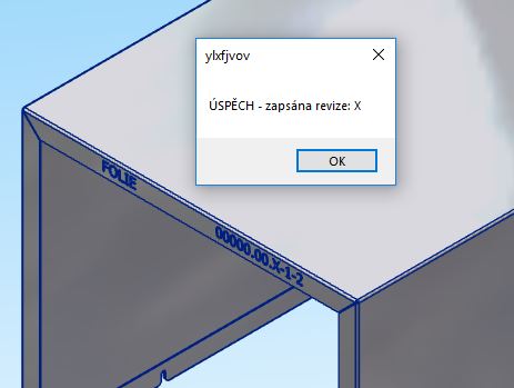

    <![CDATA[<strong>Autor:</strong> <a href="https://www.cadforum.cz/forum/member_profile.asp?PF=9">Vladimír Michl</a><br /><strong>Předmět:</strong> 28111<br /><strong>Zasláno:</strong> 05.pro.2018 v 10:35<br /><br />Titulek standardního MsgBoxu je parametr - 3.parametr při vyvolání - viz:<div>&nbsp;</div><div>MsgBox("Text zprávy", OK, "Titulek")</div><div>&nbsp;</div><div>Zmizení zprávy po timeoutu je složitější - viz tip:</div><div><a href="https://www.cadforum.cz/cadforum/jak-v-ilogic-zobrazit-zpravu-jen-na-nekolik-vterin-tip12074"><u><font color="#0066cc">https://www.cadforum.cz/cadforum/jak-v-ilogic-zobrazit-zpravu-jen-na-nekolik-vterin-tip12074</font></u></a></div>]]>

    <![CDATA[<strong>Autor:</strong> <a href="https://www.cadforum.cz/forum/member_profile.asp?PF=4903">Lukáš Záruba</a><br /><strong>Předmět:</strong> 28111<br /><strong>Zasláno:</strong> 05.pro.2018 v 10:04<br /><br />1)Je možné napsat&nbsp;<span style="color: rgb128, 0, 128; font-weight: bold;">MsgBox</span>&nbsp;tak aby neopsahoval potvrzovají okono "ok" a jen se na chvíly zobrazil bez nutnosti "odkliknout"<div><div><br><div>2) Jo možné změnit i název zprávy? nyní mi to samou generuje text "ylxfjvov" a já nevím co dělám špatně.</div><div><br></div><div><img src="uploads/4903/MATH_BOX_2018-12-05_10-02-48.JPG" height="349" width="463" border="0" />&nbsp;&nbsp;</div></div></div><div><br></div><div>Pokud ANO tak jak to mám udělat.</div>]]>
