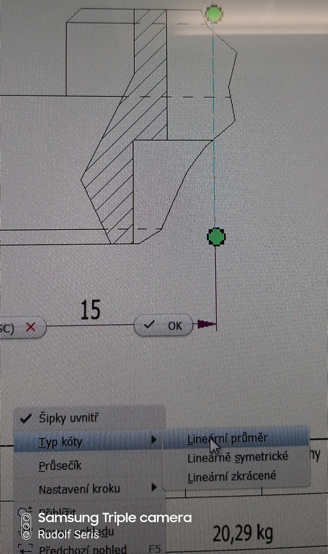

  <item>
   <title><![CDATA[kóta průměru v detailu : Dobr&#253; den,d&#283;kuji, pomohlo s t&#283;mi...]]></title>
   <link>https://www.cadforum.cz/forum/forum_posts.asp?TID=29923&amp;PID=118900&amp;title=kota-prumeru-v-detailu#118900</link>
   <description>
    <![CDATA[<strong>Autor:</strong> <a href="https://www.cadforum.cz/forum/member_profile.asp?PF=503">jeniksedlacek</a><br /><strong>Předmět:</strong> 29923<br /><strong>Zasláno:</strong> 20.led.2020 v 08:17<br /><br />Dobrý den,<div>děkuji, pomohlo s těmi automatickými osami.</div><div>Přeji hezký den</div>]]>
   </description>
   <pubDate>Mon, 20 Jan 2020 08:17:58 +0000</pubDate>
   <guid isPermaLink="true">https://www.cadforum.cz/forum/forum_posts.asp?TID=29923&amp;PID=118900&amp;title=kota-prumeru-v-detailu#118900</guid>
  </item> 
  <item>
   <title><![CDATA[kóta průměru v detailu : https://www.cadforum.cz/forum/...]]></title>
   <link>https://www.cadforum.cz/forum/forum_posts.asp?TID=29923&amp;PID=118899&amp;title=kota-prumeru-v-detailu#118899</link>
   <description>
    <![CDATA[<strong>Autor:</strong> <a href="https://www.cadforum.cz/forum/member_profile.asp?PF=1047">masa1</a><br /><strong>Předmět:</strong> 29923<br /><strong>Zasláno:</strong> 20.led.2020 v 07:45<br /><br /><a href="https://www.cadforum.cz/forum/forum_posts.asp?TID=20436&amp;KW=osa+detail&amp;title=jak-zakotovat-detail%20">https://www.cadforum.cz/forum/forum_posts.asp?TID=20436&amp;KW=osa+detail&amp;title=jak-zakotovat-detail</a>
   </description>
   <pubDate>Mon, 20 Jan 2020 07:45:17 +0000</pubDate>
   <guid isPermaLink="true">https://www.cadforum.cz/forum/forum_posts.asp?TID=29923&amp;PID=118899&amp;title=kota-prumeru-v-detailu#118899</guid>
  </item> 

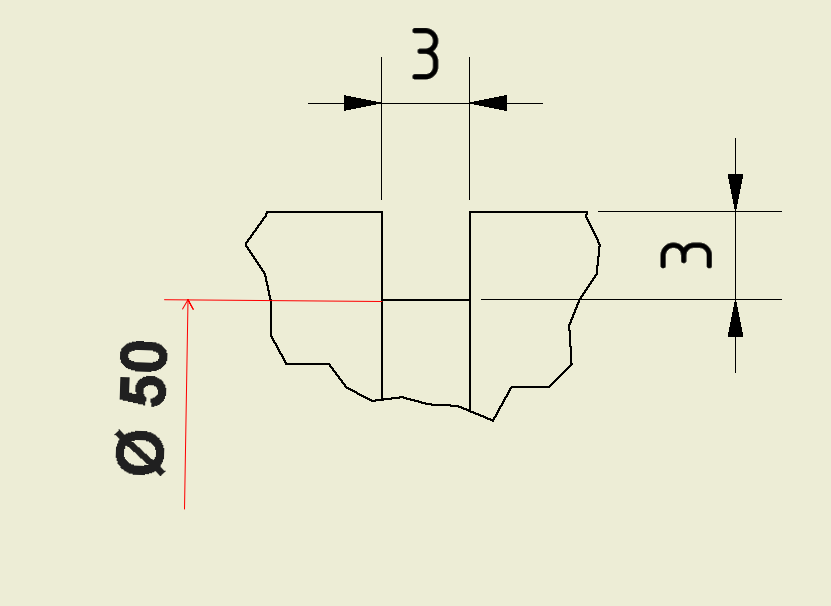

  <item>
   <title><![CDATA[kóta průměru v detailu : Asi takto. ]]></title>
   <link>https://www.cadforum.cz/forum/forum_posts.asp?TID=29923&amp;PID=118898&amp;title=kota-prumeru-v-detailu#118898</link>
   <description>
    <![CDATA[<strong>Autor:</strong> <a href="https://www.cadforum.cz/forum/member_profile.asp?PF=44188">cadman181</a><br /><strong>Předmět:</strong> 29923<br /><strong>Zasláno:</strong> 20.led.2020 v 07:00<br /><br />Asi takto.<img src="uploads/44188/20200120_065024.jpg" height="800" width="474" border="0" />]]>
   </description>
   <pubDate>Mon, 20 Jan 2020 07:00:24 +0000</pubDate>
   <guid isPermaLink="true">https://www.cadforum.cz/forum/forum_posts.asp?TID=29923&amp;PID=118898&amp;title=kota-prumeru-v-detailu#118898</guid>
  </item> 
  <item>
   <title><![CDATA[kóta průměru v detailu : Dobr&#253; den,d&#283;kuji za odpov&#283;&#271;.Ale...]]></title>
   <link>https://www.cadforum.cz/forum/forum_posts.asp?TID=29923&amp;PID=118897&amp;title=kota-prumeru-v-detailu#118897</link>
   <description>
    <![CDATA[<strong>Autor:</strong> <a href="https://www.cadforum.cz/forum/member_profile.asp?PF=75816">bernardr</a><br /><strong>Předmět:</strong> 29923<br /><strong>Zasláno:</strong> 19.led.2020 v 23:07<br /><br />Dobrý den,<div>děkuji za odpověď.&nbsp;</div><div><br>Ale jak docílit toho, když se změní součást, aby se změnil i rozměr. Takových to detailů jsou v celé dokumentaci desítky. A pamatovat si to je nadlidský úkol, kde je ručně přepsaná kóta.</div><div>???</div><div>Děkuji za jakékoliv nápady.</div>]]>
   </description>
   <pubDate>Sun, 19 Jan 2020 23:07:10 +0000</pubDate>
   <guid isPermaLink="true">https://www.cadforum.cz/forum/forum_posts.asp?TID=29923&amp;PID=118897&amp;title=kota-prumeru-v-detailu#118897</guid>
  </item> 
  <item>
   <title><![CDATA[kóta průměru v detailu : Mo&#382;n&#225; del&#353;&#237;, ale jde to.....1.vytvo&#345;it...]]></title>
   <link>https://www.cadforum.cz/forum/forum_posts.asp?TID=29923&amp;PID=118896&amp;title=kota-prumeru-v-detailu#118896</link>
   <description>
    <![CDATA[<strong>Autor:</strong> <a href="https://www.cadforum.cz/forum/member_profile.asp?PF=21449">mineza</a><br /><strong>Předmět:</strong> 29923<br /><strong>Zasláno:</strong> 19.led.2020 v 22:57<br /><br /><div>Možná delší, ale jde to.....</div><div>1.vytvořit kótu (odspoda nahoru)</div><div>2.přetahnout její horní část směrem dolů</div><div>3.přijmout</div><div>4.upravit 2. šipku na žádné</div><div>5.skrýt a přepsat kótu</div>6.skrýt vynášecí čáru]]>
   </description>
   <pubDate>Sun, 19 Jan 2020 22:57:49 +0000</pubDate>
   <guid isPermaLink="true">https://www.cadforum.cz/forum/forum_posts.asp?TID=29923&amp;PID=118896&amp;title=kota-prumeru-v-detailu#118896</guid>
  </item> 

   <title><![CDATA[kóta průměru v detailu : Dobr&#253; den,jak pros&#237;m V&#225;s ud&#283;lat...]]></title>
   <link>https://www.cadforum.cz/forum/forum_posts.asp?TID=29923&amp;PID=118895&amp;title=kota-prumeru-v-detailu#118895</link>
   <description>
    <![CDATA[<strong>Autor:</strong> <a href="https://www.cadforum.cz/forum/member_profile.asp?PF=75816">bernardr</a><br /><strong>Předmět:</strong> 29923<br /><strong>Zasláno:</strong> 19.led.2020 v 20:56<br /><br />Dobrý den,<div>jak prosím Vás udělat kótu v detailu v Inventoru, jak je na obrázku.</div><div>Děkuji<img src="uploads/75816/97050.png" height="606" width="831" border="0" /></div>]]>
   </description>
   <pubDate>Sun, 19 Jan 2020 20:56:53 +0000</pubDate>
   <guid isPermaLink="true">https://www.cadforum.cz/forum/forum_posts.asp?TID=29923&amp;PID=118895&amp;title=kota-prumeru-v-detailu#118895</guid>
  </item> 
