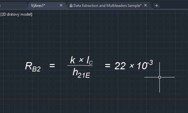

   <title><![CDATA[Zlomky s indexem - AutoCAD2020 : Zhruba to nap&#237;&#353;ete i v MText editoru...]]></title>
   <link>https://www.cadforum.cz/forum/forum_posts.asp?TID=30250&amp;PID=119710&amp;title=zlomky-s-indexem-autocad2020#119710</link>
   <description>
    <![CDATA[<strong>Autor:</strong> <a href="https://www.cadforum.cz/forum/member_profile.asp?PF=9">Vladimír Michl</a><br /><strong>Předmět:</strong> 30250<br /><strong>Zasláno:</strong> 26.bře.2020 v 17:47<br /><br />Zhruba to napíšete i v MText editoru ale je to dřina...<div><br></div><div><img src="uploads/9/vzorec.jpg" height="362" width="599" border="0" /><br></div>]]>
