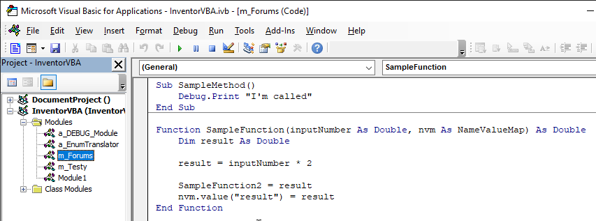

  <item>
   <title><![CDATA[iLogic / VBA Makro : Tady je uk&#225;zkaiLogicjednoduch&#233;...]]></title>
   <link>https://www.cadforum.cz/forum/forum_posts.asp?TID=34073&amp;PID=127922&amp;title=ilogic-vba-makro#127922</link>
   <description>
    <![CDATA[<strong>Autor:</strong> <a href="https://www.cadforum.cz/forum/member_profile.asp?PF=9996">Navara</a><br /><strong>Předmět:</strong> 34073<br /><strong>Zasláno:</strong> 01.bře.2023 v 10:59<br /><br /><div>Tady je ukázka</div><div><br></div><div>iLogic</div><div><br></div><div>jednoduché volání metody</div><div><table width="99%"><tr><td><pre class="BBcode"></div><div>iLogicVb.RunMacro("InventorVBA", "m_Forums", "SampleMethod")</div><div></pre></td></tr></table></div><div><br></div><div>Volání metody s parametrem a návratovou hodnotou</div><div><table width="99%"><tr><td><pre class="BBcode"></div><div><div>Dim map As Inventor.NameValueMap = ThisApplication.TransientObjects.CreateNameValueMap()</div><div><br></div><div>iLogicVb.RunMacro("InventorVBA", "m_Forums", "SampleFunction", 3, map)</div><div>Logger.Debug(map.Value("result"))</div></div><div></pre></td></tr></table></div><div><br></div><div><br></div><div>VBA</div><div><table width="99%"><tr><td><pre class="BBcode"></div><div><div>Sub SampleMethod()</div><div>&nbsp; &nbsp; Debug.Print "I'm called"</div><div>End Sub</div><div><br></div><div>Function SampleFunction(inputNumber As Double, nvm As NameValueMap) As Double</div><div>&nbsp; &nbsp; Dim result As Double</div><div>&nbsp; &nbsp;&nbsp;</div><div>&nbsp; &nbsp; result = inputNumber * 2</div><div>&nbsp; &nbsp;&nbsp;</div><div>&nbsp; &nbsp; SampleFunction2 = result</div><div>&nbsp; &nbsp; nvm.value("result") = result</div><div>End Function</div></div><div></pre></td></tr></table></div><div><br></div><div><br></div><div>Nastavení projektu VBA</div><div><br></div><div></div><div><img src="uploads/9996/2023-03-01_10-55-15.png" height="317" width="853" border="0" /><br></div>]]>
   </description>
   <pubDate>Wed, 01 Mar 2023 10:59:03 +0000</pubDate>
   <guid isPermaLink="true">https://www.cadforum.cz/forum/forum_posts.asp?TID=34073&amp;PID=127922&amp;title=ilogic-vba-makro#127922</guid>
  </item> 
  <item>
   <title><![CDATA[iLogic / VBA Makro : InventorVb.RunMacro(&#8220;projectName&#8221;,...]]></title>
   <link>https://www.cadforum.cz/forum/forum_posts.asp?TID=34073&amp;PID=127918&amp;title=ilogic-vba-makro#127918</link>
   <description>
    <![CDATA[<strong>Autor:</strong> <a href="https://www.cadforum.cz/forum/member_profile.asp?PF=26140">PopelkaM</a><br /><strong>Předmět:</strong> 34073<br /><strong>Zasláno:</strong> 01.bře.2023 v 10:10<br /><br /><em ="ph i" id="GUID-07DA57D0-B34C-49D8-8B44-5C554A07C359__GUID-141C3D9C-0618-43B3-B88A-CB994326B555" style="color: rgb51, 51, 51; font-family: monospace; font-size: 14px;">InventorVb.RunMacro(“projectName”, “moduleName”, “macroName”)</em><div><em ="ph i" style="color: rgb51, 51, 51; font-family: monospace; font-size: 14px;"><br></em></div><div><em ="ph i" style="color: rgb51, 51, 51; font-family: monospace; font-size: 14px;">Nevím co vyplnit v položce <b>projectName</b>&nbsp;</em></div><div><em ="ph i" style="color: rgb51, 51, 51; font-family: monospace; font-size: 14px;"><br></em></div><div><em ="ph i" style="color: rgb51, 51, 51; font-family: monospace; font-size: 14px;">Děkuji Popelka</em></div><div><em ="ph i" style="color: rgb51, 51, 51; font-family: monospace; font-size: 14px;"><br></em></div>]]>
   </description>
   <pubDate>Wed, 01 Mar 2023 10:10:37 +0000</pubDate>
   <guid isPermaLink="true">https://www.cadforum.cz/forum/forum_posts.asp?TID=34073&amp;PID=127918&amp;title=ilogic-vba-makro#127918</guid>
  </item> 
  <item>
   <title><![CDATA[iLogic / VBA Makro : Ano, jde to. K tomu slou&#382;&#237; funkce...]]></title>
   <link>https://www.cadforum.cz/forum/forum_posts.asp?TID=34073&amp;PID=127917&amp;title=ilogic-vba-makro#127917</link>
   <description>
    <![CDATA[<strong>Autor:</strong> <a href="https://www.cadforum.cz/forum/member_profile.asp?PF=9996">Navara</a><br /><strong>Předmět:</strong> 34073<br /><strong>Zasláno:</strong> 01.bře.2023 v 09:53<br /><br />Ano, jde to. K tomu slouží funkce RunMacro. Zde je návod<div><a href="https://help.autodesk.com/view/INVNTOR/2022/ENU/?guid=GUID-07DA57D0-B34C-49D8-8B44-5C554A07C359" target="_blank" rel="nofollow">https://help.autodesk.com/view/INVNTOR/2022/ENU/?guid=GUID-07DA57D0-B34C-49D8-8B44-5C554A07C359</a></div><div><br></div>]]>
   </description>
   <pubDate>Wed, 01 Mar 2023 09:53:13 +0000</pubDate>
   <guid isPermaLink="true">https://www.cadforum.cz/forum/forum_posts.asp?TID=34073&amp;PID=127917&amp;title=ilogic-vba-makro#127917</guid>
  </item> 
  <item>
   <title><![CDATA[iLogic / VBA Makro : Dobr&#253; den,lze iLogic pravidlem...]]></title>
   <link>https://www.cadforum.cz/forum/forum_posts.asp?TID=34073&amp;PID=127916&amp;title=ilogic-vba-makro#127916</link>
   <description>
    <![CDATA[<strong>Autor:</strong> <a href="https://www.cadforum.cz/forum/member_profile.asp?PF=26140">PopelkaM</a><br /><strong>Předmět:</strong> 34073<br /><strong>Zasláno:</strong> 01.bře.2023 v 09:44<br /><br />Dobrý den,<div>lze iLogic pravidlem spouštět VBA makro?</div><div>Obráceně to používám...</div><div><br></div><div>Děkuji Popelka</div>]]>
   </description>
   <pubDate>Wed, 01 Mar 2023 09:44:19 +0000</pubDate>
   <guid isPermaLink="true">https://www.cadforum.cz/forum/forum_posts.asp?TID=34073&amp;PID=127916&amp;title=ilogic-vba-makro#127916</guid>
  </item> 
