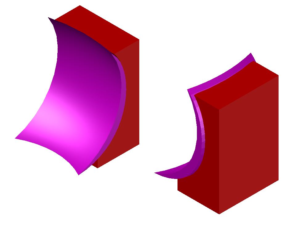

    <![CDATA[<strong>Author:</strong> <a href="https://www.cadforum.cz/forum_en/member_profile.asp?PF=165260">John Connor</a><br /><strong>Subject:</strong> 12028<br /><strong>Posted:</strong> 04.Oct.2016 at 16:23<br /><br />Yes, it does match.&nbsp; Here's proof.<br><br><img src="uploads/165260/CrescentShaped.JPG" height="737" width="980" border="0" /><br><span style="font-size:10px"><br /><br />Edited by John Connor - 04.Oct.2016 at 18:24</span>]]>

    <![CDATA[<strong>Author:</strong> <a href="https://www.cadforum.cz/forum_en/member_profile.asp?PF=298250">f-yazdand</a><br /><strong>Subject:</strong> 12028<br /><strong>Posted:</strong> 04.Oct.2016 at 09:43<br /><br />oh.. I didnt want to make you angry at all, thank you very much was a great help and I learned new commands.&nbsp;]]>

    <![CDATA[<strong>Author:</strong> <a href="https://www.cadforum.cz/forum_en/member_profile.asp?PF=165260">John Connor</a><br /><strong>Subject:</strong> 12028<br /><strong>Posted:</strong> 03.Oct.2016 at 23:23<br /><br />I outlined the steps I used to create the shape in the form of a solid.&nbsp; You'll just have to keep at it until you get it right.&nbsp; <br><br>So as it turns out it wasn't the shape of the crescent you were talking about but how it lines up with the geometry directly behind it.&nbsp; My guess from the image you provided is that you located it incorrectly.&nbsp; BTW...you can attach images to your posts directly.&nbsp; There is no need to zip the image file.&nbsp; It is totally unnecessary.<br><br>Once you have the crescent located correctly portions of the geometry behind it will have to be removed.&nbsp; You cannot use the Trim command and you cannot use the Slice command.&nbsp; Copy both pieces off to one side and subtract the crescent from the piece behind it.&nbsp; Next, use the Separate command to break the main piece (the one you want to keep) from the portion of the geometry that is of no use.&nbsp; Once you run that command and the pieces are separated delete the one(s) you don't need.&nbsp; Now swap what remains with its original.&nbsp; At this point the back of the crescent and the front of the geometry behind it should fit like a glove.<br><br>In the future, when you are commenting about something another user has provided you, free of charge and after much work, be a little bit more clear in your explanation of what you think may be "different" than what you expected otherwise someone may just get the wrong idea.&nbsp; Got it? <br><span style="font-size:10px"><br /><br />Edited by John Connor - 04.Oct.2016 at 19:12</span>]]>

    <![CDATA[<strong>Author:</strong> <a href="https://www.cadforum.cz/forum_en/member_profile.asp?PF=298250">f-yazdand</a><br /><strong>Subject:</strong> 12028<br /><strong>Posted:</strong> 03.Oct.2016 at 20:53<br /><br />Thank you but not matched ...<div><a href="uploads/298250/not_matching.zip" target="_blank" rel="nofollow">uploads/298250/not_matching.zip</a><br></div>]]>

    <![CDATA[<strong>Author:</strong> <a href="https://www.cadforum.cz/forum_en/member_profile.asp?PF=165260">John Connor</a><br /><strong>Subject:</strong> 12028<br /><strong>Posted:</strong> 03.Oct.2016 at 17:56<br /><br />Where are you located exactly?<br><br>I've attached a copy of the crescent created as a solid.&nbsp; Have fun.<br><br><a href="uploads/165260/yazdand_crescent_solid.dwg" target="_blank" rel="nofollow">uploads/165260/yazdand_crescent_solid.dwg</a><br><span style="font-size:10px"><br /><br />Edited by John Connor - 03.Oct.2016 at 20:03</span>]]>

    <![CDATA[<strong>Author:</strong> <a href="https://www.cadforum.cz/forum_en/member_profile.asp?PF=298250">f-yazdand</a><br /><strong>Subject:</strong> 12028<br /><strong>Posted:</strong> 03.Oct.2016 at 17:45<br /><br /><a href="uploads/298250/loft_step.zip" target="_blank" rel="nofollow">uploads/298250/loft_step.zip</a><div><br></div><div>Hi Jhon,&nbsp;</div><div>so to make sure i am following the right steps I created an image from the shapes Im trying to loft</div><div>1- I have the crescent as Cross sections which &nbsp;I select both of them</div><div>2- I choose Guides and then select the curve ( the one in the bottom of the crescent)</div><div>but loft not giving me any shape ....it fails...</div><div><br></div><div>thank you &nbsp;</div>]]>

    <![CDATA[<strong>Author:</strong> <a href="https://www.cadforum.cz/forum_en/member_profile.asp?PF=165260">John Connor</a><br /><strong>Subject:</strong> 12028<br /><strong>Posted:</strong> 01.Oct.2016 at 12:42<br /><br />You have to use the GUIDES option when lofting the pull the model into its proper shape.&nbsp; In this case it would be at least one guide at the bottom or the top of the crescent.<br>]]>
