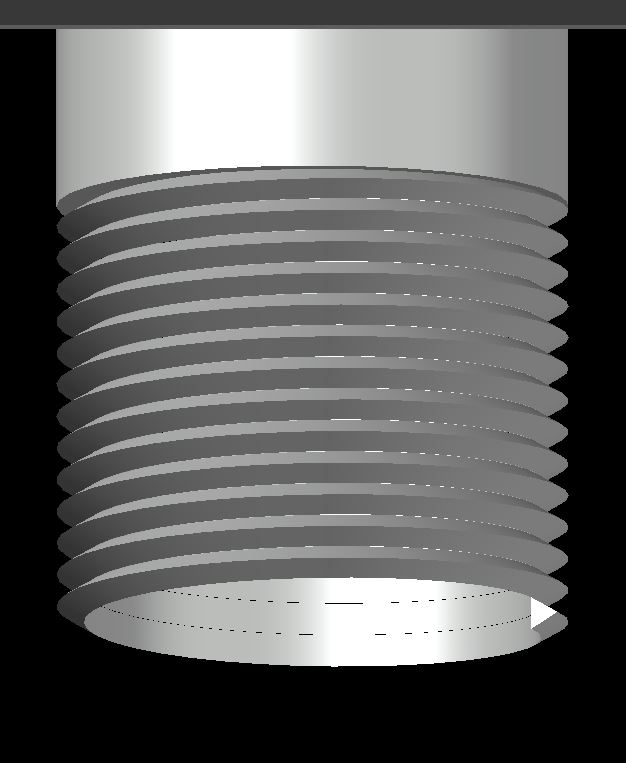

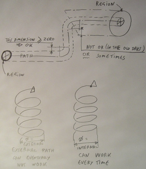

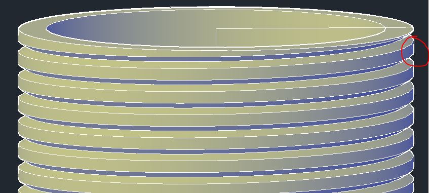

    <![CDATA[<strong>Author:</strong> <a href="https://www.cadforum.cz/forum_en/member_profile.asp?PF=175428">philippe JOSEPH</a><br /><strong>Subject:</strong> 12578<br /><strong>Posted:</strong> 02.Jan.2018 at 22:32<br /><br /><img src="uploads/175428/3D_thread_06.JPG" height="594" width="513" border="0" /><div>Hello carlosban71, sometimes you're maybe unable to sweep for example if the radius of your helix is too little for your region to be sweeped, that's why I proposed to you to use the internal diameter of the thread instead of the outside.<div>In the old days you couldn't extrude along a path if the internal of your region would interfer with the radius of your polyline path but I see that you have succedded in creating your own threaded tube..&nbsp;</div></div><span style="font-size:10px"><br /><br />Edited by philippe JOSEPH - 02.Jan.2018 at 22:44</span>]]>

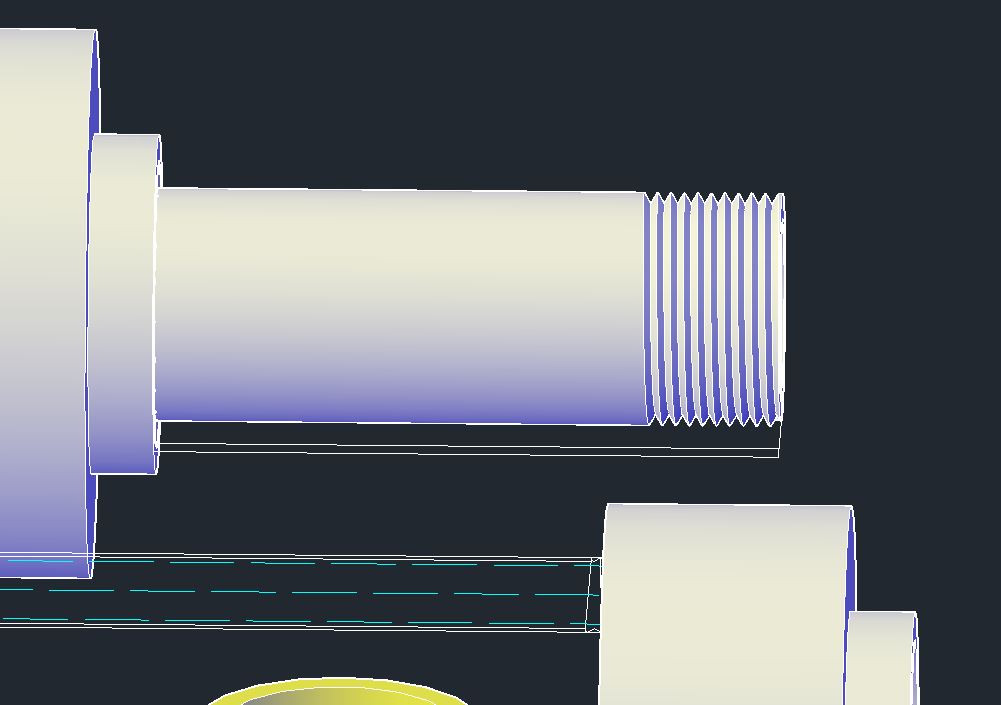

    <![CDATA[<strong>Author:</strong> <a href="https://www.cadforum.cz/forum_en/member_profile.asp?PF=759803">carlosban71</a><br /><strong>Subject:</strong> 12578<br /><strong>Posted:</strong> 02.Jan.2018 at 22:21<br /><br /><div>Happy New Year 2018</div><div><br></div><div>A Purpose, of so much practice, now yes. I got the thread</div><div>Now, the message pops up (unable to sweep)</div><div>Query why? (unable to sweep) Did I do something wrong?</div><div><br></div><div><img src="uploads/759803/Captura-01.JPG" height="705" width="1001" border="0" /><br></div>]]>

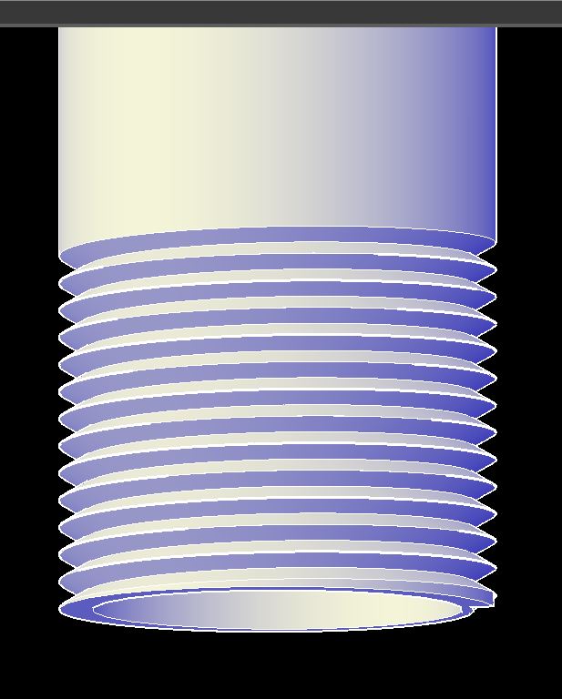

    <![CDATA[<strong>Author:</strong> <a href="https://www.cadforum.cz/forum_en/member_profile.asp?PF=165260">John Connor</a><br /><strong>Subject:</strong> 12578<br /><strong>Posted:</strong> 02.Jan.2018 at 13:02<br /><br />Actually, I like this one a little better.<br><br><br><br><img src="http://www.cadforum.cz/forum_en/uploads/165260/SweepIt2.JPG" height="768" width="617" border="0" /><br><span style="font-size:10px"><br /><br />Edited by John Connor - 02.Jan.2018 at 13:02</span>]]>

    <![CDATA[<strong>Author:</strong> <a href="https://www.cadforum.cz/forum_en/member_profile.asp?PF=165260">John Connor</a><br /><strong>Subject:</strong> 12578<br /><strong>Posted:</strong> 02.Jan.2018 at 12:50<br /><br />Is this the result you are attempting to achieve?<br><br><img src="uploads/165260/SweepIt1.JPG" height="763" width="626" border="0" /><br>]]>

    <![CDATA[<strong>Author:</strong> <a href="https://www.cadforum.cz/forum_en/member_profile.asp?PF=175428">philippe JOSEPH</a><br /><strong>Subject:</strong> 12578<br /><strong>Posted:</strong> 31.Dec.2017 at 08:38<br /><br />Hello carlosban71, I'm still here.<div><div>Maybe your material removal is a little outside of the tube but the concept is OK, just showing a flat part at the external diameter.</div><div>Is your helix diameter the same as the tube external diameter ?</div><div>Maybe a test with a helix on the inside diameter of the triangle showing the material would generate a good material removal.</div><div>In the old times you couldn't extrude along a path if the radius was too little.</div><div>I'm at home without AutoCAD, back to work next january the 2th.<img src="uploads/175428/3D_thread_05.jpg" height="393" width="636" border="0" /></div></div><span style="font-size:10px"><br /><br />Edited by philippe JOSEPH - 31.Dec.2017 at 08:46</span>]]>

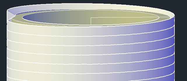

    <![CDATA[<strong>Author:</strong> <a href="https://www.cadforum.cz/forum_en/member_profile.asp?PF=759803">carlosban71</a><br /><strong>Subject:</strong> 12578<br /><strong>Posted:</strong> 31.Dec.2017 at 01:58<br /><br />As I found the fault, perio now I get squared, it has to come out triangle tip<div><br></div><div><img src="uploads/759803/hilo7.JPG" height="278" width="641" border="0" /><br>&nbsp;<div><br></div><div><img src="uploads/759803/hilo8.JPG" height="381" width="847" border="0" /><br></div><div><br></div></div>]]>

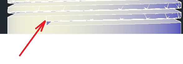

    <![CDATA[<strong>Author:</strong> <a href="https://www.cadforum.cz/forum_en/member_profile.asp?PF=759803">carlosban71</a><br /><strong>Subject:</strong> 12578<br /><strong>Posted:</strong> 31.Dec.2017 at 01:56<br /><br />As I found the fault, perio now I get squared, it has to come out triangle<div><br></div><div><img src="uploads/759803/hilo7.JPG" height="278" width="641" border="0" /><br></div><div><br></div><div><br></div>]]>

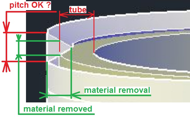

    <![CDATA[<strong>Author:</strong> <a href="https://www.cadforum.cz/forum_en/member_profile.asp?PF=175428">philippe JOSEPH</a><br /><strong>Subject:</strong> 12578<br /><strong>Posted:</strong> 30.Dec.2017 at 23:02<br /><br /><img src="uploads/175428/3D_thread_03.jpg" height="208" width="588" border="0" />Carlosban71, I don't know why it's not working perfectly because if you have SUBTRACT your sweeped solid from your tube it should be OK and complete.<div>One the other hand when I look at the bottom of your last posted picture it looks like half of a SUBTRACT is still here.</div><span style="font-size:10px"><br /><br />Edited by philippe JOSEPH - 30.Dec.2017 at 23:07</span>]]>
