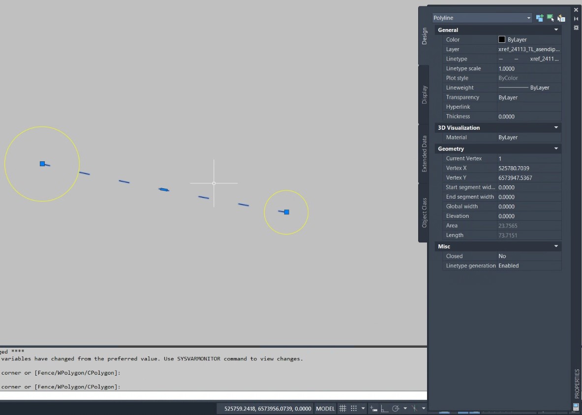

HI
I've used linexp lisp to explode linetypes into pieces. But with latest AutoCAD2026 its seems not to work it used to. Explodes the lines but objects jump randomly to different places in drawings.
Has anyone have a solution for it?
Thank you in advance!

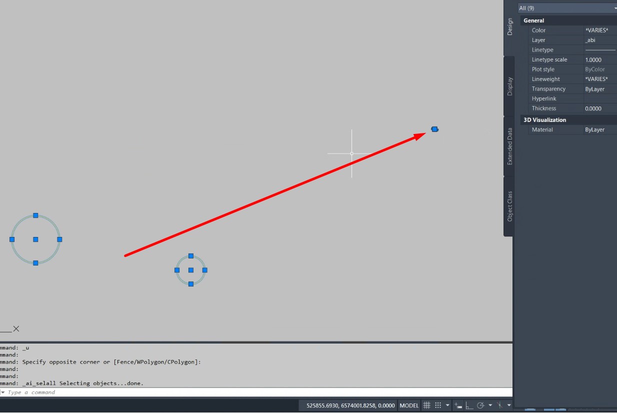

Post Options Post Options   Thanks (0) Thanks(0)   Quote Ingmars Quote  Post ReplyReply Direct Link To This Post Posted: 09.Jan.2026 at 11:50
Snapmode and orthomode 0 or 1.
result seems to be same - exploded objects scale and appear far from the original location.

Post Options Post Options   Thanks (0) Thanks(0)   Quote Vladimir Michl Quote  Post ReplyReply Direct Link To This Post Posted: 09.Jan.2026 at 13:49
I have noticed that your coordinates are far from origin. This could cause numerical instability in AutoCAD. Can you temporarily move your geometry closer to 0,0 and redo the LinExp?
If it won't help, send me please your DWG to the webmaster's e-mail address in the footer.

Post Options Post Options   Thanks (0) Thanks(0)   Quote Ingmars Quote  Post ReplyReply Direct Link To This Post Posted: 09.Jan.2026 at 14:07
Moving closed to 0,0,0 didn't help. Will send email. Tnx in advance.
