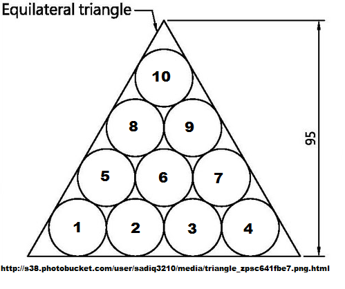

Hi, its my first post here, i use AutoCAD2010.
Below is the link of pic of the drawing i m talking about.
I can create this drawing by.
1. making 1 circle of bottom row 10 radius. 2. copy that to the right 3 times
3. make another circle with ttr of above row 4. copy that to right 2 times
5. repeating same steps 2nd row 6. and top circle .
7. then making boundary line with xline (horizontal) and using line command + tan + bject snap tracking.
8.  Trim and scale the whole figure with reference of given dimension.
I have 2 questions here.
1) Is there any simpler way to make this drawing?
2) How can i build this drawing if i first make the triangle and then circle?

Posted By: sadiq3210
Date Posted: 08.Mar.2014 at 21:32
http://s38.photobucket.com/user/sadiq3210/media/triangle_zpsc641fbe7.png.html

Posted By: Robert_D
Date Posted: 10.Mar.2014 at 21:06
Originally posted by sadiq3210 sadiq3210 wrote:
...if i want to make the triangle first and then make the circles, how can i do it ??
Measure side length of triangle. Divide by 11.464101615137753. Result will be radius of circle(s).
Date Posted: 11.Mar.2014 at 10:36
Originally posted by John Connor John Connor wrote:
I'm beginning to lose interest as I no longer see where this is all going.  Is there a practical reason for this discussion or are we having it because someone got bored at work?
the only question remaining is that, how to find the radius of circle ?
Date Posted: 11.Mar.2014 at 15:32
the length of side of triangle is 109.6966
after dividing by 11.464101615137753
it give. r=9.66870442 hich is wrong.
the correct radius of circle is 11.5908

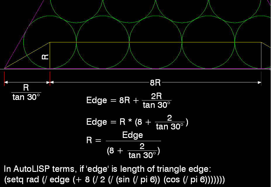

Posted By: Robert_D
that method will not give the exact radius.
Drawing triangle w/ arbitrary sides of 10 units in length, radius = 0.87228815093505.
(@ max LUPREC in AutoCAD, radius properties = 0.87228815)
Zooming in max on intersections of circumferential circles and triangle, there is no gap or overage.
AutoCAD recognizes them as intersections.
How much more precision is required?
PS: formula= 8+(2xsqrt3)
Courtesy Erdős/Groemer (1961)
Posted By: Robert_D
Date Posted: 11.Mar.2014 at 15:48
it give. r=9.66870442 which is wrong.
??? That would = 5 circles w/ d 23.18 X 5 = 115.9 units in length?? How could that fit inside your 109.69 triangle?
Check your math. r=9.56870444. If you say r= 11.59, something has changed with your geometry.
PS: I just drew it up quickly (@109.6966) and it is quite precise.
Posted By: Robert_D
Date Posted: 11.Mar.2014 at 16:15
Apparently now you are stacking 10 circles in triangle NOT 15 (you should have told us).
Whereby formula now is 6+(2xsqrt3) & r = 11.5908096152033
Posted By: John Connor
Date Posted: 11.Mar.2014 at 16:24
Maybe if the OP wouldn't change the rules in the middle of the game we'd all have a better idea of what is going on.  Go figure.
<<AutoCAD 2015>>
Posted By: Kent Cooper
Date Posted: 11.Mar.2014 at 21:26
That's for FIVE Circles in the bottom row.  Change the 8 to 6 for FOUR Circles, etc.
Copy/pasteable:
(setq rad (/ edge (+ 8 (/ 2 (/ (sin (/ pi 6)) (cos (/ pi 6)))))))
Date Posted: 11.Mar.2014 at 22:24
Or, yes, the square root of 3 works too -- a little less code:
(setq rad (/ edge (+ 8 (* 2 (sqrt 3)))))
[Again, substitute 6 for 8 to get the radius for four Circles.]
Yup, and substitute 4 for 8 to fit 3 circles, 2 for 8 to fit 2 circles.
4 + 2√3,
2 + 2√3

Kent Cooper, Did autoCAD generated all these equations automatically? or you manually did all these ?
If AutoCAD automatically created this, then how?
Posted By: rs_higgins
Date Posted: 12.Mar.2014 at 21:24
This is a tangent exercise.
Start by building you triangle 95 high
then draw a line from endpoint top to midpoint bottom.
repeat all three sides so you have a 3 way cross it the middle of the triangle.
using the circle command CIRCLE then type 3p  enter then pick your points as tangent
the color X's will create the circle of the same color.
You will need to complete the red or green first to use it to make the blue.
Then you can work you way around from there.
A quick note the center circle is created for 3 circle.
Okay did this yesterday did not see the part about 3 time to get all the circles.
Date Posted: 13.Mar.2014 at 14:00
I came up with the formulas myself.  It's only a little trigonometry and algebra, and finally a conversion into AutoLISP syntax.
Date Posted: 13.Mar.2014 at 14:07
>>... Start by building you triangle 95 high
>> then draw a line from endpoint top to midpoint ....
[That works when you want four Circles along each triangle edge, but not for other quantities such as the five in the original image.]
Date Posted: 13.Mar.2014 at 15:52
Ok got in late I guess for the original image from the link "http://s38.photobucket.com/user/sadiq3210/media/triangle_zpsc641fbe7.png.html" shows 4 must have changed.
If you would for those that came in late. What are the list of thing you would like for this. I enjoy this type of thing but need all the rules in one place. Thanks

no, no want to make it with constraints.
see this half worked diagram
http://i38.photobucket.com/albums/e109/sadiq3210/Untitled_zps1e5de5c4.png
Date Posted: 14.Mar.2014 at 19:42
It doesn't use constraints, but assuming Circle 3 in your diagram is supposed to remain tangent to the crossing Lines in the middle, the criteria in the diagram will be met by using CFP and 5 Circles along each edge.
