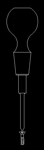

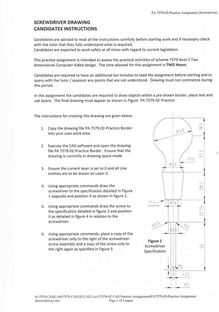

Hi there,
I am coming towards the end of my first year of an AutoCAD course at night school and have been given a mock exam which is, apparently, very similar to the end of year online exam. Please can I ask for some help. The mock exam is in two parts, I have posted the links to the first exercise, below, and was hoping that someone could please either post a video or some screenshots on how to complete it. I wouldn't ask if I wasn't struggling slightly.
Thank you for any help, I do appreciate this.
http://i199.photobucket.com/albums/aa214/craigten/EXAMA.jpg
http://i199.photobucket.com/albums/aa214/craigten/EXAMB.jpg
http://i199.photobucket.com/albums/aa214/craigten/EXAMC.jpg
http://i199.photobucket.com/albums/aa214/craigten/EXAMD.jpg

You been in an AutoCAD class for a year and you are having trouble figuring out how to draw a screwdriver and a screw in 2D and only a single view of each?  I'm finding that difficult to believe.  The screwdriver is basically arcs and lines.
For starters I would begin at the tip of the screwdriver.
Post an image of what you have done so far.

Posted By: John Connor
Date Posted: 15.Mar.2014 at 12:04
At the end of one 4 hour class we had basically the same assignment.  At the end of 12 weeks of classes, 4 hours per night/2 nights per week, we had to do a completely dimensioned drawing of a complex machine part that included a top, front, side and isometric view.  Now that is what I would call a fairly good final exam.
The screwdriver pictured should take no more than 15 minutes to draw and that is while drinking a cup of coffee at the same time.
<<AutoCAD 2015>>

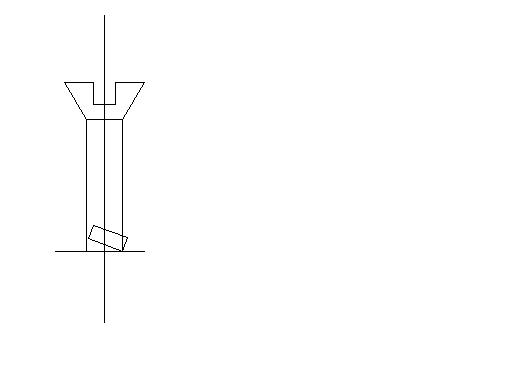

Thank you JC, yes I know it is simple but as I mentioned it is only part of the exam and, you're right, I think they give 30 minutes for this first part. The second part is more complicated and I think they give 2 hours for that. The problem on our course is that we have many people and one tutor and is very hard to get help/advice.
Just a point, I can't post it right at this moment but a problem I am having is that I am getting the head/handle of the screwdriver like you do (The R15 and the 22 Diameter) but, like you, the drawing is not the same as the exercise. Can you see what I mean?

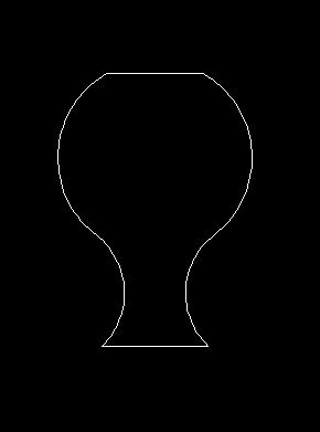

Yes, I know your drawing may vary slightly from the one pictured.  I think there is something not quite right with the last dimension at the top of 18.5; in my opinion this is wrong.  You add that to the 37.5 dimension and end up with an overall dimension of 56.0 which seems way too high.  Is there anyway to contact the instructor and get some clarification?
Maybe the R15 is wrong?  I suppose you could hold the height of 56 and adjust the radius to get something that looks more like the picture.

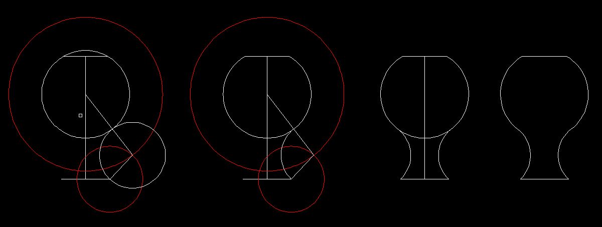

Date Posted: 15.Mar.2014 at 12:57
I think I got it.  Circle > TTR won't cut it.  I had to use an offset and a construction circle to arrive at the right center point for the radius 15 circle.  The overall height is now 56.  See what another cup of coffee will do for you.  Sorry for misleading you earlier.
<<AutoCAD 2015>>
Date Posted: 15.Mar.2014 at 12:59
Does this look better?
<<AutoCAD 2015>>
Posted By: Bobdob
Date Posted: 15.Mar.2014 at 13:01
It sure does!!!
Thanks so much....I'll get on that tonight, I'm off to football now but I am so happy I have a better idea.
Thank you JC
Date Posted: 15.Mar.2014 at 13:06
This is the approach I took.  I offset the circle (dia. 40) 15 units.  I drew another circle with a radius of 15 units.  Both shown in red.  Where they intersected I drew (or copied) another circle with a radius of 15 then trimmed away what I didn't need, mirrored the resultant arc and trimmed/erased what was left to end up with the top of the screwdriver handle.
Hope this helps.  Go to go.  I have a pressure relief valve to buy for my furnace.
Again, I apologize for misleading you.
Good luck.
<<AutoCAD 2015>>

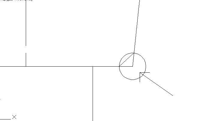

OK, thank you. Here is where I have to put the chamfer but am unsure of what exactly the '1 x 1' is?

Bobdod, you have a command CHAMFER with the settings of 2 values that you will set at 1.
You can also draw a circle radius 1 with its center at the extremity of your arrow and modificate le lines with their grips or with the command TRIM.

Date Posted: 16.Mar.2014 at 14:38
Imagine you drew a circle with a diameter of 1 unit and used the intersection of the two lines your arrow points to.  Now where the circle intersects with the horizontal and vertical lines imagine you drew a new line from intersection to intersection.  That would be your chamfer.  The new line would be at a 45 deg angle.

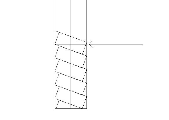

Date Posted: 16.Mar.2014 at 15:32
For starters the depth of the notch (where the screwdriver tip would go) is supposed to be 2.1; your depth measures 1.4 instead.
Not sure how you actually constructed the threads but it appears you have a total of 10 overlapping lines which is not a good habit to get into.
<<AutoCAD 2015>>

The faint yellow lines are where our two screws differ (circled in red).  Like I said, you are very close.  A bit of tweaking and you will be there.
<<AutoCAD 2015>>

Originally posted by John Connor John Connor wrote:
You're very close.  What seems to be the problem?
As you can see, below, I have made a rectangle, chose the dimensions 1.4 width (which the drawing says is the dimension) and chose 3.5 length (which is what I assumed, but did not KNOW was the length), then I chose to rotate it 340 degrees as the drawing says 20 degrees. But then as you can see below, the rectangle does not fit between the horizontal guidelines like it should. Basically I do not know the length of the rectangles and do not know how to find out?
Date Posted: 16.Mar.2014 at 16:47
The 3.5 is not the width of the rectangle.  The width has to be shorter.
Anyway, you were so close before why are you redoing it?  I think you had the right size for the rectangle originally.  Look at the image I posted previously.  Our rectangles match.

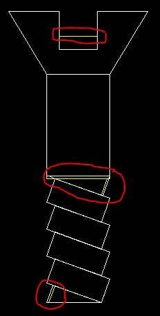

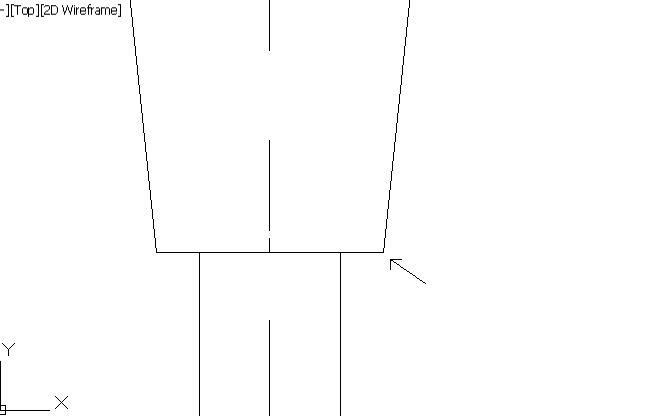

Posted By: Bobdob
Date Posted: 16.Mar.2014 at 17:15
JC, neither of these cut off points (in red) seem to correlate perfectly with the drawing exercise I have?
Posted By: Bobdob
Date Posted: 16.Mar.2014 at 20:51
I've just started from scratch and come up against the same problem again, where to cut it off. The cut off line does not correlate with the exercise?:
Date Posted: 16.Mar.2014 at 21:43
Use the lower of the two lines.
<<AutoCAD 2015>>

But you see where I have highlighted in red, below, is so different to what we would see if I chose the bottom red line on mine:
Do you see what I mean?
Date Posted: 17.Mar.2014 at 10:58
The distance between the two vertical white lines is 3.5.
The blue vertical line represents the lower right hand corner of our rectangle.
The white diagonal line at the top represents where the partial rectangle should be.
The red diagonal line is where the line is drawn in the diagram.  The difference between the two diagonal lines is 0.0739.  If you were looking at the drawing after it was printed you would not know the red line was in the wrong position.
My advice...put the line where your teacher expects to see it based on the diagram and move on unless you have a mop of hair that rivals a sheepdog.  Otherwise you'll spend 1 hour doing the drawing and 16 hours worrying over it.
