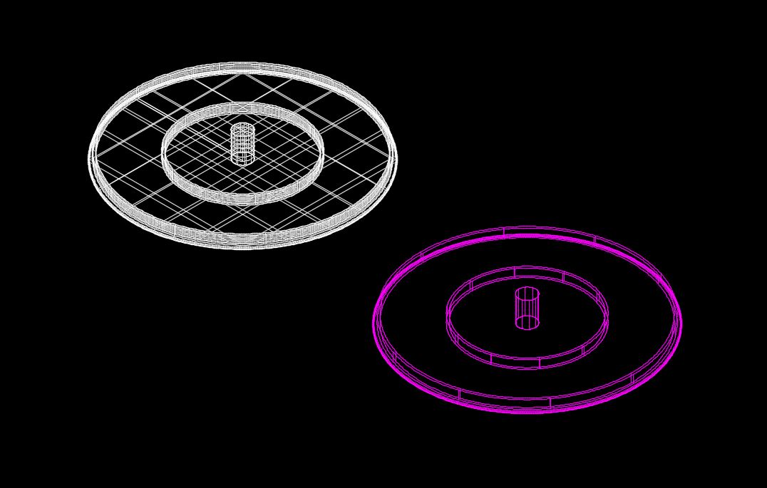

Dear guys, please help me. Is there anyone know how to convert my draw into 3D solid? For your information, there's 32 surfaces can't be converted into 3D solid. And I don't think thicken is the way to solve this problem. Thanks before.

1. Create a closed polyline profile.
2. Reorient it and draw a single line (red) where shown below.
3. Use the REVOLVE command and its OBJECT feature.
4. Revolve around the red line 360 degrees.
5. Done.
Remember: If you revolve lines you'll end up with surfaces.

My next problem is I can't convert it into solid. There's 44 objects can't be converted. Because i want export the drawing into .stl file

You wouldn't have to convert it to a solid had you followed my directions.  See my first reply and do what I said.
BTW...I opened my version of the drawing which DOES contain a solid and I was able to export it as a .STL file to my Desktop.

No you can't send me an email.  If you followed my directions and used a closed polyline as the profile for the object then the end result would have been a solid.  I know because I did it myself.  I would not suggest a solution unless I knew it would work.  I usually test these things before posting.
What command did you use to try and convert the surfaces to a solid?  And don't tell me you used THICKEN.

AutoCAD 2013?  Do you have the SURFSCULPT command?  If so you can use that to convert your object surfaces to a solid.  I know because I just did it.  I exploded my polyline profile to just lines and arcs and revolved it.  I ended up with surfaces.  Then I used the SURFSCULPT command to convert to a solid.  The white object shown below is comprised of multiple surfaces while the magenta object is a solid.

And, finally.. YES.. BIG YES.. Thanks Sir.. I'm happy with your instruction.. Greetings from Indonesia..

look, it works and done. Now I know how to convert the surface (revolve) into 3D solids. Great Clap
