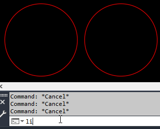

Draw two Circles.  Position them as appropriate.  Draw a Line using TANgent Object Snap for both ends.  Mirror the Line across each Circle's CENter point.  Trim out the unneeded parts of the Circles.

Posted By: dery
Date Posted: 13.Apr.2024 at 19:31
How do you draw the slanted line that tangent to the two circles like this?
Posted By: Kent Cooper
Date Posted: 16.Apr.2024 at 19:17
As I described before, simply draw a Line using TANgent Object Snap for both ends.  You can pick anywhere on the Circles that's reasonably close to where the real tangent points will be, and AutoCAD will work it out.
