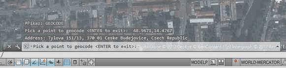

A - answer The free add-on application CADstudio GeoCode for AutoCAD 2014+ (plus Map/Civil/Architecture 2014 and higher) performs the "reverse geocoding" - it generates the nearest street address (postal address) from a given point - the street, number, ZIP code, city and country. You only need to position your DWG drawing (map) to the real location using the command GEOGRAPHICLOCATION, i.e. with Live Maps.
Load the GeoCode.vlx file and run the GEOCODE command. After each clicked point, its full street address is displayed (the address of the nearest place).
Video (city of Ceske Budejovice):
The current layer must be on. In Map and Civil you need to have assigned a real coordinate system or use LiveMap.
