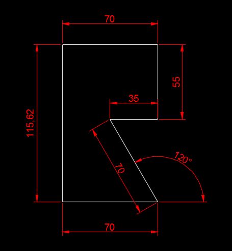

Hello. Im just starting to use AutoCad and need some help to understand it. If someone could do this easy figures for me in a Autocad and at he same time tell me step by step what you're doing I would be SUPER happy! These figures should be very quickly done if someone knows autocad. Thank you very much <3

Posted By: John Connor
Date Posted: 15.Oct.2015 at 11:52
It should take you less than five minutes to draw the lines AND dimension them as well for the first two figures.  I know because I just did it.
For figure one make sure Orthomode is enabled then start the line command.  Pick your start point then drag your cursor to the right.  STOP.  Go to your command line.  Type in the number 70.  Now drag your cursor upwards.  STOP.  Go to the command line and type in the number 20.  Keep repeating until you have drawn all the lines.  This is called direct entry input.
Date Posted: 15.Oct.2015 at 12:24
What do you mean you haven't had any classes?  How can you have an assignment but not have a class?
Have you looked at any online tutorials?
You type the dimension of 70 after the AutoCAD prompt.  This is what you should see on screen:
Command: L
LINE
Specify first point: you pick your first point onscreen
Specify next point or [Undo]: 70
Now do you understand?
<<AutoCAD 2015>>
Date Posted: 15.Oct.2015 at 12:32
We'll make this one easier with a three step process.  You'll need to use either the Trim or Fillet command to clean up the intersection of the two crossed lines.
<<AutoCAD 2015>>
Date Posted: 15.Oct.2015 at 12:46
If you have never used AutoCAD how would you know anything about it?  Your instructor should go back to school.
Did you drawn figure one?
The oblique lines in figure two can be drawn in a couple of ways.  If you know the length and angle that can be typed in at the command line during the course of using the Line command.  Example:
@60<45
The above translates as "at a length of 60 units and an angle of 45 degrees".
@120<135
The above would translates as "at a length of 120 units and an angle of 135 degrees".
By the way, AutoCAD assumes a "0" degree angle is pointing to the 3 o'clock position and all angles are turned counterclockwise.
Another way to construct the oblique lines would be to use temporary construction lines and offset them the required distances.  Are you familiar with this technique?  Have you heard of the OFFSET command or even know how to use it?
<<AutoCAD 2015>>
Date Posted: 15.Oct.2015 at 13:15
Originally posted by Sarah90 Sarah90 wrote:
Understood. How do you get the oblique lines in figure 2? Sorry for being stupid :)
How to draw figure two using temporary lines and the OFFSET command.  Temporary lines are in green.
The magenta colored line was duplicated by means of the COPY command.
<<AutoCAD 2015>>
