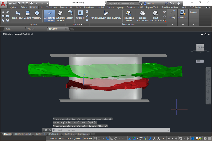

Now we have to prepare the "sides" and "top" and "bottom" part of the future 3D solid. For this, we have to cut the existing top and bottom planes of the trim-box (prism). Use the PLANESURF command to draw an auxiliar plane surface and copy it (grips) above the top terrain and below the bottom terrain, so that it still cuts the box:
Use the Surface > Edit ribbon and its command SURFTRIM to cut the trim-box. Follow its prompts - you have to select the trim box, then the cutting plane and again the box (above the plane in the top case, below the plane in the bottom case).
